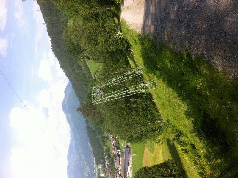

Thanks everyone for getting the physics minds working on this, here is a pic of a small chair lift pylon, my walk yesterday unfortunately did not go near any of the bigger cable cars, some of which are the same - off vertical pitch (Sorry photo posted at 90 degrees -couldn't figure out how to reorientate from my phone). I sketched a diagram on a napkin the other day of the diff loads and I still think there is more forces when added together acting to pull the pylon structure down the hill than if the pylon was vertical. Do they just super engineer the base do it can take this extra force, the tower at an angle then helps the cars travel up hill?
Sorry if I am being naive and obvious!

The pylon appears roughly perpendicular to the cable, which makes sense to me.
As for the FBD I just play cut the rope in my mind and it's obvious. Cut the pylon and which way would the cable sag.
It also appears the design was chosen to minimise the impact of free-standing structure weight compared to cable weight.

Nice photo , those hills of Austria are impressive! I can't see the cable that well, but on the right of the pulley traveler, it more or less departs horizontally, while to the left of the pulley, it departs sharply downward. Since the cable tension on each side of the pulley is more or less equal, but acting in different directions, it's resultant force acts downward along the bisector of the obtuse angle between the cables. By inclining the pylon 'tower' along this bisector, the
Cable load from the resultant force, which can be quite large due to the high tension in the cable (which is a function of cable weight, equipment weight, etc.) acts along the inclined axis, eliminating overturning forces along line. The tower is quite strong across line due to the spread truss design, in order to resist wind forces and other across line loads, but along line, the tower has little strength due to its narrow base, so these along line forces on the tower are minimized by orienting the tower as shown. It is true that the tower weight itself now tends to produce overturning downhill, but the tower weight is rather small by comparison. I can't tell if the tower sits on a foundation or whether it is directly buried in the ground with a grillage to resist uplift and bearing forces, but in any case, costs of foundation design is smaller than the vertical tower case.

Comprehensive Phantomjay, thank you for your thoughts an effort. This photo wasn't a usual cable car pylon, just a wee ski lift up a tiny grassy slope, most of the cable car systems went up really steep slopes and had several very large towers that were all on the piss or sloped, would that make any difference to loads? (no horizontal section of catenary in cables) .

Even when the tower is on a steep slope with an adjacent tower downhill and the other adjacent tower uphill, there is still an unbalanced horizontal tension component uphill. Depending on span lengths and cable sags, the departure angle downhill is steep, and the departure angle uphill may not be horizontal, but it is much less steep since the low point of the cable sag on the uphill side is close to the tower (and conversely, the low point of the sag on the downhill side is far from the tower). So you still get a resultant load acting along the axis of the tower appropriately inclined along the approximate bisector
of the angle between the downhill and uphill cable.
