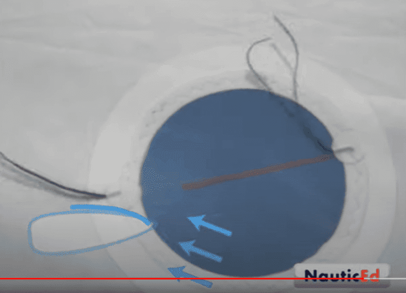

This question is about sail aerodynamics, more precisely what cause spanwise airflow at the sails?
When sailing close hauled,at the jib windward middle and top tell tales stream up or at 45 degress up, all others leeward and bottom windwards tell tales stream horizontaly.
1. What cause airflow to switch direction so windward tell tales stream up?
2. How to trim the jib to all tell tales stream horizontaly?
Is it because jib is angled to leeward so airflow has component parallel with luff instead parallel with cord line?
Just like aircraft swept wing has wingspan airflow?
I know that means your angle of attack is too low, but not why the direction is up. But to make it clear for others, this photo might help. The green string on the windward side is pointing up while the red string on the leeward side is pointing back.
Photo of a sail with a blue circular overlay and blue arrows; a dark string on the left trails back and a reddish string runs across the middle, with a blue loop drawn near the lower left edge.
8View attachment 313775
Yes but at your picture it seems like windward (green tell tale) is stalled, my tell tales is not stalled ,it is straight(have tension) just stream up...
It flops around a bit. Watch the whole video.

The sail is tapered towards the top rather than being rectangular, so as with a similar shaped aeroplane wing, the airflow leaks away towards the end of the aerofoil, giving it an upward tilt.
Then why does the other-side telltale not follow the same argument?
The opposite telltale is not in a laminar stream as the airflow has become detached.

Sounds like a little too much twist in the sail, in other words the middle and top of the sail are too open. The top tell-tale streaming up might be OK on your boat (it isn't on mine) but you should definitely get the middle one streaming backwards: sheet in harder or move the sheeting position (jib cleat or genoa car) backwards. You will often find the best position is when the leach (rear edge) of the sail is parallel with the centre line of the boat.

Air moves from higher pressure to lower pressure. If there is too much twist there will be less pressure at the top of the sail.
