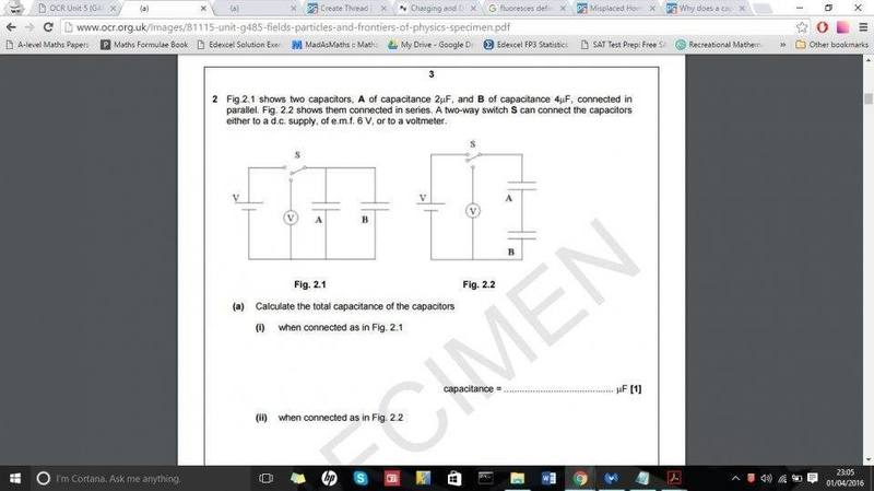

Here is the question I am referring too. I am not cheating on hwk or anything rather seeking help on a question. It is only worth one mark and what I am referring to is 2di.of the uploaded image, with the initial question attached.
So given what I said about the internal resistance of the DVM, why will the capacitor(s) discharge slowly when the DVM is measuring their voltage? Are you familiar with how RC circuits work?
Since it will discharge through the voltemeter. Since there is high resistance, then capacitance decreases from the Time constant=RC therefore the high resistance will result in a slow discharge?
Since it will discharge through the voltemeter. Since there is high resistance, then capacitance voltage decreases from the Time constant=RC therefore the high resistance will result in a slow discharge?
Mostly correct except for the typo I fixed. :smile:

Basically the voltmeter and the capacitor are in series, so the main resistance in the circuit is the internal resistance of the meter. That and the value of the capacitance give you the RC time constant of the decay of the capacitor voltage.

Not exactly. The voltage v(t) across the capacitor decays with the time constant RC because the internal resistance of the DVM is across the capacitor when it is measuring the capacitor voltage. The time constant is RC, so a bigger capacitance means that the capacitor voltage takes longer to decay towards zero. And a bigger resistance (in this case in the DVM) means that the capacitor voltage takes longer to decay towards zero.
