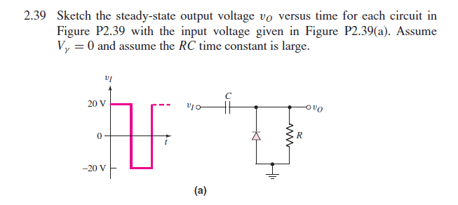

Why does a clamper circuit shift the input voltage upward by 20V?

Hello everyone, I hope you could help me with the analysis of this circuit.
the output voltage is supposed to be similar to the input but shifted upwards by 20V, so basically it's between 0 and 40V... but why?
I mean when the input is 20V, the diode is reverse biased... and the capacitor charges... our output voltage depends on the ratio of the resistance to the capacitive reactance... at least until the capacitor fully charges... but then what happens?
Thank you
no. They told you the time constant is large, so the capacotor does NOT charge through the resistor.
Your thought tool should be this: "Time constant is large, eh? If i take that to the extreme how would the circuit behave? Limit would be infinite time constant... so what would go on if that resistor were nearly ∞ or not even there ? "
In your mind snip out that resistor and repeat your thought experiment , considering both Vt transitions.
I really can't see where this is going, a bit more insight would be highly appreciated...
I mean a very high resistance would mean almost 0 current given that the voltage supply is constant... but that doesn't really get me anywhere..
Also sir, they said that the time constant is large... how would we know if that indicates a large resistance or a large capacitance.. since the time constant is RC and dependent on both...
Thank you!
What about the diode ?
looks to me like voltage goes from +20 to -20 then back to +20, maybe repeating that forever they didn't say .
You are not operating the circuit in your mind.
Got it sir, I forgot that the diode would determine the voltage drop Vo...
