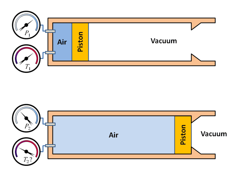

Post #6 (yours) in this thread gave me a different way to visualize the problem of temperature after air has escaped from a bottle, thanks. This is how I visualize it:
  • Imagine a perfectly rigid and insulating tube floating in the weightless vacuum of space, closed on one end.
  • There is a piston locked in the tube, holding in non-dry air.
  • We have one temperature sensor, at the closed end of the tube, measuring temperature T1, and one pressure sensor measuring P1.
  • We may know the initial volume of air, but it shouldn't matter.
  • The piston is released and the air expands, pushing the piston outward.
  • At some point, the piston encounters an obstruction and stops moving. At this time the pressure in the tube is P2.
  • Mass is irrelevant. Work is force × distance, and force is simply the pressure multiplied by the area of the piston, which travels a distance before stopping.
  • We don't know the final volume of the air, and we don't care, we just are concerned with the temperature sensor at the closed end of the tube.
  • This is a reversible process, not free expansion.
  • The question is, what is the temperature T2 of the air measured at the closed end of the tube?

I'm having trouble visualizing what you are describing. Can you please provide a diagram? I'm particularly wondering why you feel that this process is reversible.
The other facts in the original problem, about letting the bottle come to ambient temperature before releasing the air, the volume of the bottle, the ambient pressure, and so forth, are distractions. The basic facts are: you have an initial P1 and T1, and you have a final P2, and need to know T2. Possibly the mass of air going through the neck of the bottle is relevant (analogous to the mass of air that moves past the initial position of the piston in my visualization), but I am not sure.

Certainly. The original problem was the first post of this thread: https://www.physicsforums.com/threads/temperature-drop-in-an-expanding-gas.549795/
Original problem statement: A 2-liter soda bottle contains 5 bars of air pressure at 20°C. The surrounding environment is 1 bar at 20°C. What is the temperature inside the bottle after the pressure is released?
More general problem statement: Compressed air (a real gas) at pressure P1 and temperature T1 decompresses rapidly to pressure P2. What is the new temperature T2?
We can assume a perfectly rigid and insulating bottle, for simplicity. A complication might be that the air isn't dry. Someone asking questions about pressurizing plastic soda bottles is likely asking due to an interest in the hobby of water rocketry, because that's the primary reason why you'd want to pressurize a 2L bottle to 5 bars. So the air in the bottle will contain water vapor.
If we further assume that the bottle ejects its air into a perfectly insulating bag that provides no back pressure, then the process should be reversible: You can perform work to squeeze the same air back into the bottle, which should be the same work that pushed out the air in the first place. So in my previous message I proposed an alternative model that should be analogous to the original problem:
I thought at first that this is reversible. Work is done to move the piston out, and you can do the same work to move it back... but now I'm not so sure. My illustration above looks a lot like a Joule expansion, which isn't reversible.

Before getting into the soda bottle problem, I would like to first focus on this problem. Some questions:
1. Are you assuming that the piston is frictionless, or does it experience frictional forces from the wall of the cylinder?
2. Are you assuming that the piston has mass, or can its mass be assumed to be negligible?
I'm assuming the piston has negligible friction. This is analogous to air leaving the bottle without resistance, as if the bottle had no neck, just an opening at one end of a cylinder. The only resistance would be from displacing the air outside.
I assume that the piston also has mass, but I believe the mass should not matter, because the work performed on the piston (force times distance) is independent of mass. The more the mass, the slower the piston will accelerate, but its kinetic energy when it hits the stops will still be the same regardless of the mass. Furthering the analogy, the piston's mass would be analogous to the mass of air outside the bottle that gets displaced by the air escaping to the outside of the bottle. So a good assumption might be that the mass of the piston equals the mass of the compressed air.
One thing I neglected to mention: we know the mass of the compressed air. In the real-life bottle experiment, we would know the mass of compressed air in the bottle, if we already know its temperature, pressure, and density (assuming it's water-saturated - as it is in the real world, as evidenced by the water-relief valves found on workshop air compressors).
I was thinking of another way to go about solving this, using the work performed on the piston and subtract it from the energy of the compressed air, using a numerical technique with very small time steps. We know the initial force on the piston. That force will move the piston Δd in time step Δt, expending work ΔW. Then subtract ΔW from the energy in the air at each time step, which will have a corresponding effect of reducing both temperature and pressure (although I don't know the relationship yet), without needing to know initial or final volume. Then on the next time step, we have a lower pressure for performing work. Repeat until the piston hits the stop and you get the final temperature. I'm just brainstorming here - does that make any kind of sense? Using the bottle analogy, the work performed by the pressurized air might be the force on the air inside the neck of the bottle times the distance that air was moved through the neck.
Compressed air tanks are so common, and their internal heating or cooling are so commonly observed by everyone from auto mechanics to scuba divers, that you'd think the thermal physics of air escaping from a tank would be a textbook problem! But I cannot find anything online that shows anyone has actually solved it for a real-world example.
If the piston is massless, then the gas does no work whatsoever. From a force balance on the piston $$P_{gas}A=ma=0$$. So, in the limit of zero piston mass, $$P_{gas}\rightarrow 0$$. This is the gas pressure at the piston face. For an irreversible expansion like this, the pressure within the cylinder is non-uniform spatially, so even though the gas pressures at other locations are greater than zero, the value at the piston face approaches zero. So, negligible work is done by the gas on the piston, and no heat is transferred during this irreversible expansion. So, from the initial and final states of the system, $$\Delta U=Q-W=0$$
If the piston has mass, then the gas does work on the piston to accelerate it. But the kinetic energy gained by the piston converts back to internal energy when the piston is stopped by the detent. So, here again, $$\Delta U=0$$For an ideal gas, it its change in internal energy is zero, its change in temperature is zero. For a real gas, since internal energy also depends on specific volume, there is a small Joule-Thompson change in temperature (related to the non-ideal gas behavior).
I was thinking of another way to go about solving this, using the work performed on the piston and subtract it from the energy of the compressed air, using a numerical technique with very small time steps. We know the initial force on the piston. That force will move the piston Δd in time step Δt, expending work ΔW. I was thinking of using the kinetic theory of gases to subtract ΔW from the energy in the air at each time step, which will have a corresponding effect of reducing both temperature and pressure, without needing to know initial or final volume. Then on the next time step, we have a lower pressure for performing work. Repeat until the piston hits the stop and you get the final temperature. I'm just brainstorming here - does that make any kind of sense? Using the bottle analogy, the work performed by the pressurized air might be the force on the air inside the neck of the bottle times the distance that air was moved through the neck.
This solution method would not work because the gas within the cylinder is not uniform with respect to its spatial pressure distribution and temperature distribution. To get the details of what is happening temporally and spatially within the cylinder, one needs to solve the partial differential equations of gas dynamics, typically using computational fluid dynamics software. But the beauty of thermodynamics is that, for many problems like this one, one only needs to focus on the work and heat at the boundaries (if your interest is only in the final state of the system).
Moran et al, in Fundamentals of Engineering Thermodynamics solve a problem for the air temperature in a tank as air leaks out (slowly). The problem can also be solved for rapid irreversible leakage.
