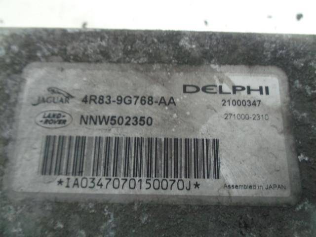

The one you mentioned from the Range Rover was likely built by Delphi Automotive.
Other makers are: Autoliv, Continental, Magna International, Valeo, Hyundai Mobis, VBOX Automotive, Mando, Robert Bosch, ZF-TRW, TRW Automotive, WABCO and Denso.
And then, the radar model can be adapted for a particular auto maker. So there is no reason to believe that they will perform in the same way.
The best source for what the unit does would be the Car's Owner's Manual.
