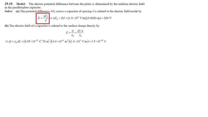

In my book it says that the electric field (E) is equal to the following
E = -dV/dx <0
where V = Volatage and x = position
However if you look in the paint doc on one of my homework problems you will see that
E>0
They say that E = dV/dx = Δv/Δx (where Δx = d).
So E = Δv/Δx > 0 (because E is UNIFORM therefor dV/dx = Δv/Δx)
Questions:
1. When should I use the equation E = -dV/dx?
2. Why did they not use E = -dV/dx?
3. Is E a vector in this equation? Hence the neg sign indicates direction
  • Solution page for problem 29.19 on a parallel-plate capacitor: E = ΔVc/d highlighted in a red box, giving ΔVc = Ed = 200 V, then Q = ε0AE = 3.5×10^-10 C.

I believe in this case they are using "E" as the magnitude of the electric field.
Always.
But the real equation is E = - del V where
del V = ∂V/∂x i + ∂V/∂y j + ∂V/∂z k
where i , j and k are unit vectors in x,y,z direction resp.
Reason: the E field may point in a direction with x, y and/or z components, not just x.
