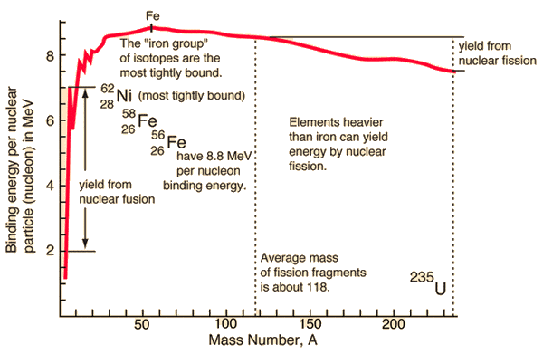

Whether fission or fusion releases energy depends on the binding per nucleon, which depends (among other things) on the mass of the nucleus. This is summarized in the binding energy curve :
See for instance Nuclear Binding Energy (hyperphysics)

That's exactly why there is an upper limit that is energy favorable around the iron atom.

The semi-emperical mass curve is usually on a log scale. This linear scale really demonstrates how much more energy there is per nucleon when fusing H rather than fissioning something heavy.
Said a bit more simply:
How much binding energy neutrons & protons have is not constant. In fact, it is a function of the number of neutrons and protons in the nucleus. The curve that they are showing shows binding energy / (neutrons + protons).
To get the energy out you want to move closer to the peak binding energy / (neutrons + protons) (which is the iron peak) this can be done from either side. For fusion, this means moving right along the curve. For fission, this means moving left.
