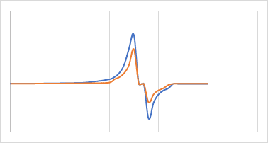

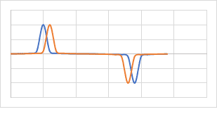

I read your paper. It has only words, not numbers or plots. So to help you out, here is how I would design it. I have no idea if goalref is really designed like this.
I would put 2 sets of coils in the goal posts, separated in distance by the width of the goal line. Then I get 2 signals as the ball passes through.
Here is how the signals versus time might look as the ball passes the goal line and stays in.
Here is the case where the ball goes all the way over, then bounces out some time later.
Here is how they might look if the ball went halfway over the line, came to a full stop, then bounced back out.
You could generate a whole family of such plots, one for each percentage of the ball over the line.
I think you can see how a computer looking at those curves can come to conclusions about what happened including what percent of the ball crossed the line.
I did not calculate anything for those curves. They are just eyeball estimates. But they illustrate the principles much better than words.
