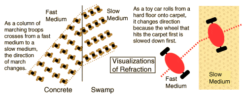

Yeah sure, change in speed of light as it travels from one medium to another. But why does it affect the path? I mean, shouldn't the light ray just go in the same direction with a different speed? Why does it have to change its path?

If we think light as a wave
Cause for refraction of light.
I have heard those examples before, but do they actually explain the phenomenon? Or do they just give a similar situation where the direction changes with speed? Bottomline, does light change direction for the same reason as the above phenomena?
The example given in #2 is a very general property of wave behavior - it works for light, sound, ripples in water, etc. It can be shown by an application of the Hughens' wavelet principle, ~1678 by Christiaan Huyghens:
http://en.wikipedia.org/wiki/Christiaan_Huygens#Optics
If you know differential equations you can derive this behavior from the wave equation:
http://hyperphysics.phy-astr.gsu.edu/hbase/waves/waveq.html
This is usually done in an upper level physics course such as electromagnetic field theory or optics.
Yes, light is an EM wave and the examples given are the reason refraction occurs.
