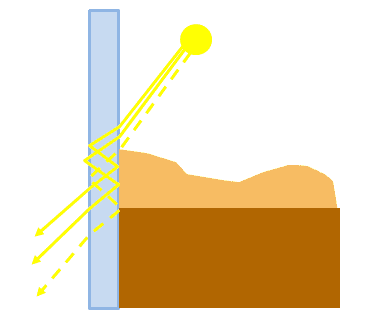

I hope this picture below will help
Diagram of sunlight from the upper right striking a clear vertical pane, with yellow rays refracting and reflecting, one dashed ray grazing a sandy dune surface that casts a shadow region on the right.
The dashed line marks the ray that is barely obstructed by the sand's surface, the point where this ray reflects the second time marks the start of the shadowy region.

Ooooh ok. That makes total sense. Thank you! Did you make that just to explain it to me? This forum is great.

If we take a look at the boundary between the light and dark region in the photos in the first post, the border shape follows almost exactly the shape of the sand surface that is exposed to the direct light. I don't think a stratification process can be the cause of such perfect congruence.

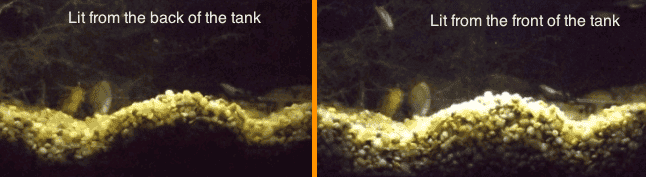

I observe the same phenomenon in my fish tank, and that worked!
Placed flat on the gravel, there was still illumination.
But placed flat against the glass, there was no illumination.
So the light was being internally reflected by the glass.
I also did some laser testing with a white cd, at and below the surface of the gravel.
I like blue_leaf77's illustration the best, as it best illustrates that the lit band is due to the non point source nature of the lamp.
With the laser beam, I was able to illuminate only the spot an inch below the level of the gravel.
Everything above and below that was dark.
Unless! I increased the vertical angle, and then I had multiple points illuminated, with diminishing intensity, similar to A.T.'s illustration.
But as BvU correctly stated in post #2, nmsurobert's band is due mostly to a single reflection.
Moving the fish tank lamp forward, will increase the height of the lit band of sand.
Two side-by-side photos of a gravel bed in an aquarium, labelled 'Lit from the back of the tank' (left) and 'Lit from the front of the tank' (right), showing a glowing band of gravel.
ps. My fish must think it's the weekend and time to party, as it's after 1am and the lights are still on. And that laser light show. Woo Hoo!

I have a fish tank, though as you can see from my image, it is filled with pebbles instead of sand. Some of the pebbles are somewhat translucent, so this complicates the matter. But with front illumination, there is no visible stratification.

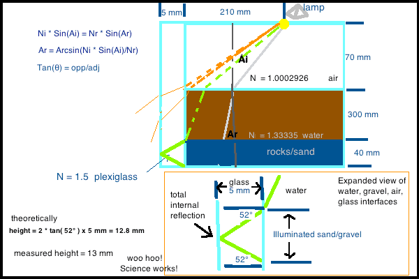

In trying to understand the height of the lighted portion, I did the maths yesterday. It was very complicated, as I had to shift directions by 90° after the light hit the water.
Anyways, after much head scratching, my maths claimed that the light should illuminate the top 12.8 mm of gravel, based on angles, and the 5 mm thickness of the glass. So I dug my mostly opaque cd out of the trash, stuck it against the side of the tank at the bottom, and the top 13 mm were illuminated.
Diagram of a light path through a fish tank: lamp at top, 210 mm across, 70 mm air, 300 mm water over rocks/sand, 40 mm base, 5 mm glass wall, with an expanded view of total internal reflection at the glass.
Nothing is drawn to scale, nor are the angles displayed correctly.
The angles only represent the relative change of direction of the light paths.​
ps. I've been an aquarist for about 50 years, and had never noticed this phenomenon before. Hence, my interest.
