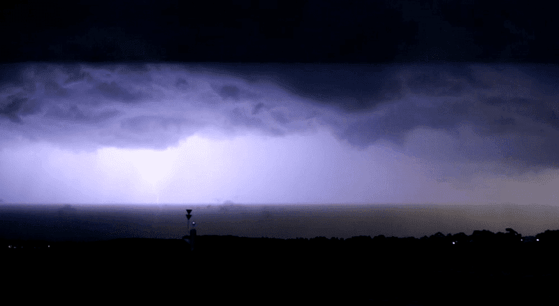

firstly ... where you doing video ( movie mode) or photo mode ?
show us an example if what you captured
If video, it is caused by the shutter method used in today's modern cameras and it's a total pain in the butt for us serious storm photographers
whilst awaiting your image, does it look anything like this one ? ...
this is just one frame out of a video. when viewing the video at normal speed all you see is a
wide band of flickering bright light, much as the OP describedDave
It took me several looks to realize what you're referring us to.
The top fifth of the image is blocked out.
and the lower 1/3 is excessively darkened. because of the shutter
This is the effect caused by the rolling shutter system used with CMOS sensor cameras ... tis extremely frustrating
Cameras with CCD chips ( there are very few left unfortunately) use a global shutter. The difference is that the CCD
imaging system using the "global shutter" system where the signal from the whole chip is switched on and off. rather than just a scrolling band of exposed sensor.
As a result, I'm still using an 8 year old CCD chipped camera with horrible low resolution. Unfortunately, there is
nothing more modern that I can replace it withDave

It was in video mode. My camera is a Sony Exmor RS IMX240.
The funny thing is that I see these bright bands even if my camera is pointed away from the lightning when it strikes.
Makes sense. Lightning is bright enough to briefly light up your whole environment bright as day. And it happens very fast. So, as far as the camera is concerned, whether it is pointed at or away from the flash, it is immaterial to its inability to capture the image.

yup, confirms my suspicion ... just say thankyou to CMOS sensors and rolling the shutter system
there isn't anything you can do about it
