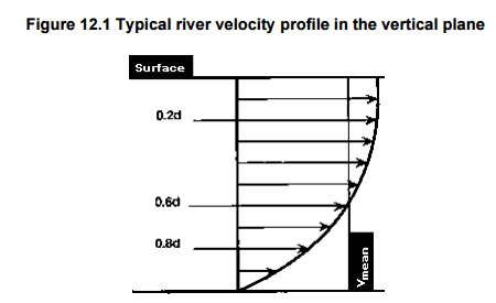

Here's the velocity profile of the water across the depth . I don't understand why The max velocity occur at the top surface[/B]
Is it because the friction on the top surface of water only comes from the below , whereas for the water below the top surafce , it has higher friction from the moving on the top , and moving water beneath it ... Is my concept correct ? [/B]

Hi.
What's holding back the water ? The viscous friction with something that doesn't move, namely the bottom. So all transport of horizontal momentum takes place in a vertical direction - as you can see from the variation in velocity going from 0 at the bottom to max at the surface.

The friction at the top surface (i.e., the shear stress) is zero. There is friction at the bottom surface because of the non-slip boundary condition.
Do you mean as the depth increases , the shear stress increases, causing the velocity to decreases parabolically from top surface to the bottom >
Yes
Chestermiller said:
Yes
can you explain further why the shear stress will increase with depth ?

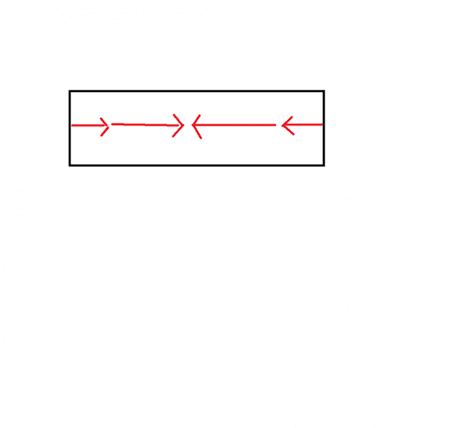

Chestermiller said:
Since the fluid at the wall is stationary (the velocity at the wall is zero), and you have a volumetric flow rate, the velocity has to be higher away from the wall. This means that the velocity gradient at the wall must be positive. From Newton's law of viscosity, that means that there is a shear stress at the wall. So you have shear stress at the wall and no shear stress at the interface with the air. So the shear stress must be increasing with distance from the wall.
Do you mean the shear stress increase to max from the wall to the center ? Which means the shear stresss is max at the center at particular depth ?
No. It is zero at the top and maximum at the wall. It decreases linearly with distance from the wall.

fonseh said:
can you show the graph of shear stress ? I'm very confused now ... Do you mean the shear stress increases from zero at the top down to the bottom ?
Yes.

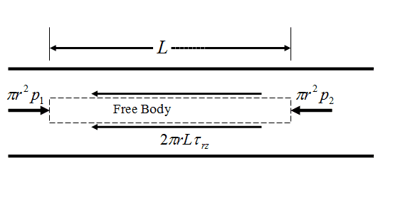

In the Wiki article on viscous laminar flow in a tube, they do an axial force balance on the shell of fluid between radial locations r and r+Δr. An easier way to analyze the problem is to do an axial force balance on the plug of fluid between r = 0 and arbitrary radial location r:
$$\pi r^2\Delta p+2\pi r L\tau_{rz}(r)=0$$where ##\Delta p## is the pressure drop between the inlet and outlet of the the section of pipe under consideration, L is the axial length of the section of pipe, and ##\tau_{rz}(r)## is the shear stress the radial surface of the plug (i.e., at constant r in the z direction). From this equation, we get that:
$$\tau_{rz}=-\frac{\Delta p}{2L}r$$
This tells us that, for steady flow in a pipe, the shear stress varies linearly with radial distance from the axis.
