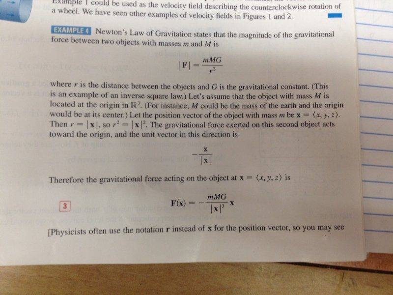

1. The problem statement, all variables and given/known
according
to my calculus III textbook, the gravitational force acting on an object at ##x = <x,y,z>## is ##F(x)=-\frac{mMG}{|x|^3} x ##. What's the point of having a cube on the bottom. Why shouldn't I memorize it as ##F(x)=-\frac{mMG}{|x|^2} ##
See above

Photo of a printed textbook page showing Example 4, Newton's Law of Gravitation, with the vector form F(x) = -mMG/|x|^3 x boxed as equation 3, plus the surrounding text on position vectors and unit vectors.
x is a vector. ##G\frac{M m}{|\mathbf{x}|^2}## is the magnitude of the force, while ##\frac{\mathbf{x}}{|\mathbf{x}|}## is a unit vector in the direction of the force.
