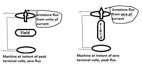

I know that decoupling the 3 phase currents we get the id and iq (in rotor frame) currents which control the flux and torque respectively. But where does the relation come from?
I think ( don't know for sure ) that if we have an instant stator current, Istat, that induces a B-field ( Bstat ) which has an angle α to Brotor,
then the Istat is decomposed into Id = Istat * cos α , Iq = Istat * sin α.
In this way Id will not yield any torque, because BId has an angle to Brotor = 0.
BIq has angle to Brotor = 90°, so Iq will yield a torque.
That's why a vector-controlled system tries to control Id to be zero, thus increasing the efficiency of the motor.

It may help you to imagine a simplified machine with a one turn armature and permanent magnet field
from a thread last year
that old thread addressed armature reaction
but it's a short hop from there to torque.
https://www.physicsforums.com/threads/armature-reaction-drop.826513/#post-5191404
