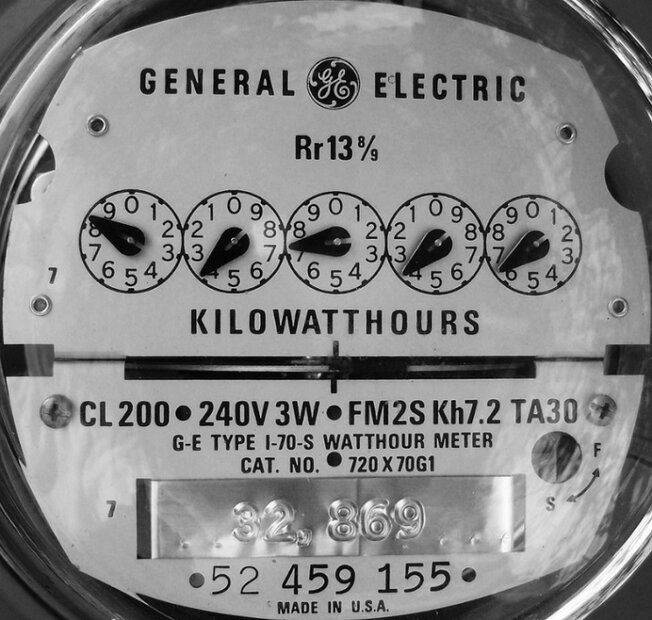

I think he's talking about the spinning disk in an electromechanical watt hour meter like this one:
The disk rotates at a speed proportional to the power going through the meter. This Wikipedia page, under the Operation: Electromechanical header describes the principles of operation: https://en.wikipedia.org/wiki/Electricity_meter.
I believe he's calling it a motor because it spins when powered electrically.
@jrmichler may have it. Hee is what Wikipedia says. The most common type of electricity meter is the electromechanical watt-hour meter.[14][15] supply, the electromechanical induction meter operates through electromagnetic induction by counting the revolutions of a non-magnetic, but electrically conductive, metal disc which is made to rotate at a speed proportional to the power passing through the meter. The number of revolutions is thus proportional to the energy usage. The voltage coil consumes a small and relatively constant amount of power, typically around 2 watts which is not registered on the meter. The current coil similarly consumes a small amount of power in proportion to the square of the current flowing through it, typically up to a couple of watts at full load, which is registered on the meter.
The disc is acted upon by two sets of induction coils, which form, in effect, a two phase linear induction motor. One coil is connected in such a way that it produces a magnetic flux in proportion to the voltage and the other produces a magnetic flux in proportion to the current. The field of the voltage coil is delayed by 90 degrees, due to the coil's inductive nature, and calibrated using a lag coil.[16] This produces eddy currents in the disc and the effect is such that a force is exerted on the disc in proportion to the product of the instantaneous current and instantaneous voltage. A permanent magnet acts as an eddy current brake, exerting an opposing force proportional to the speed of rotation of the disc. The equilibrium between these two opposing forces results in the disc rotating at a speed proportional to the power or rate of energy usage. The disc drives a register mechanism which counts revolutions, much like the odometer in a car, in order to render a measurement of the total energy used.

As I pointed out in post #2, a couple of days ago, the integrator disk is used in energy meters.
That Wikipedia entry mentions all three fields involved.
Firstly the field due to the current coil.
Secondly, a quadrature field due to the current in the inductive voltage coil.
And thirdly, the fixed permanent magnetic field that completes the disk motor.
The one thing it left out were the three or four small holes, approximately 1 mm in diameter, through the aluminium disk that introduce sufficient loss, to prevent the almost ideal disk creeping when no real power is being drawn.
