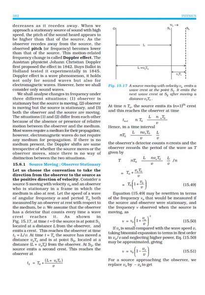

Revered members,
I have attached the image of Doppler effect explanation.
I have the following doubts
1)t1 = L/v
2) t2 = T0 +( L + vsT0)/v
But why T0 comes here, instead of ( L + vsT0)/v
  • Textbook diagram of a source moving toward a stationary observer, with wave crests spaced closer ahead and labelled S1, S2, O, L, and v_s T0 distances, illustrating the Doppler effect for a source moving at velocity v_s.
A stationary source emits waves of frequency F and period 1/F. The period is the time it takes successive wave fronts to reach you. How does the period change when the source moves away from you? First you need to know how far the source moves in the time 1/F, that is simply 1/F times the source velocity v_s. Now how much is the period lengthened? By the extra time it takes wave to go the extra distance v_s/F which is delta_t =v_s/Fv where v is the wave velocity. So the new period between wave fronts of a moving source is
1/F' = 1/F + v_s/Fv = 1/F(1+ v_s/v)
Makes more sense to me thinking of the period then the frequency?
If you are troubled by what is written derive the formula yourself.
Thanks for the reply Spinnor. I don't understand the line given in quote.
