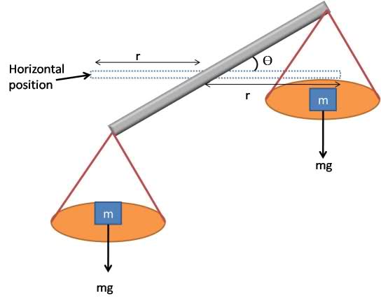

When a body is weighed on an ordinary balance we demand that arm should be horizontal if the weights on two pans are equal. Suppose equal weights are put on two pans, the arm is kept at an angle with the horizontal and released. Is the torque of the two weights about the middle point (point of support) zero? Is the total torque zero? If so, why does the arm rotate and become horizontal?
Here's what i think so far:-
Diagram of an unequal-looking balance arm tilted at angle Θ, with two identical pans of mass m hanging from each end by strings; each pan has a downward arrow labelled mg, and dashed horizontal reference lines show distance r from the pivot on each side.
(Sorry for a bad drawing :) )
For the first part, individual torque is not zero. For each weight the torque is mgrcosθ.
For the second part, the total torque is zero since the torques of weight are in opposite direction.
Now i am confused in third part. Since the net torque is zero, the balance should not move but that's not observed. Then why does it come to the horizontal position? :confused:

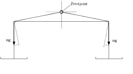

Schematically something like this:
Schematic of a balance arm pivoting at a point above a horizontal bar, with two pans hanging from the ends each labelled mg, and dashed lines showing the arm tilted.
Real scales often have ornately shaped arms that tend to disguise the offset of the pivot from the horizontal line joining the pan attachment points.
If you take the torques about the actual picot point, I think you'll see a difference in the contributions from each pan when the arm is at an angle to the horizontal.

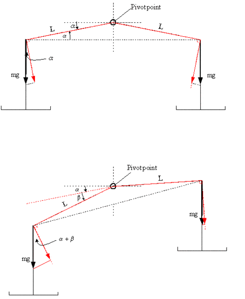

I still don't get it.
I am having problems taking the perpendicular distances.
Maybe i am not able to visualize when the arm is kept at an angle.
Can you please show me a figure to help me?
Thanks! :smile:
Thanks! :smile:
Here's a diagram. I've indicated the appropriate angles for the left hand pan. You should work out the angles for the right hand pan yourself.
Two-panel diagram of a balance arm pivoting about a central pivot point, with arm length L, angle alpha, and masses mg hanging from each end; lower panel shows the arm tilted by a further angle beta, with the left pan angle labelled alpha plus beta.
  • Two diagrams of a balance arm with a central pivot point and two pans hung by lengths L, each pan carrying a weight mg; the second shows the arm tilted by angle alpha plus beta with angles marked.
I am sorry for asking stupid questions but what does those red arrows represent. :rolleyes:
They are perpendicular to the line joining the pivot point to the point of application of the force. What do you think they might represent?

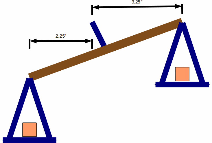

I've also made a picture. :shy:

Two diagrams of a balance with a pivot point at the top and two arms of length L, each holding a mass mg; red arrows show forces at the arm ends, and angle alpha and alpha plus beta mark the tilt of the arms.
I am assuming the red ones are the forces causing torque ... but the one on the right is not really perpendicular to arm as the left one ... why?
It is perpendicular to the arm. The arms are also in red.
