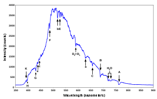

Anything that emits light has an emission spectrum.
Here is the emission spectrum for the Sun:
...it is close to that of a blackbody with a temperature of around 5800K.
The dark lines in the solar spectrum are the absorption spectrum of the individual elements that the Sun is made of. You see them as sharp troughs in the curve (pic. above).

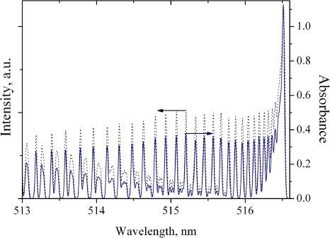

The carbon-arc spectra also shows a fine structure.
(Note: The width of the spikes owes more to the detector than the source.)

I suspect OP is just asking how come you get a full rainbow when you put light from a carbon arc through a prism, but not when you put light from hydrogen or mercury ... the answer will be that the prism presumably used was just not an accurate enough instrument to separate out the spikes in the carbon-arc spectra ... presumably it wouldn't be able to separate the orange peaks in the sodium spectra either.
