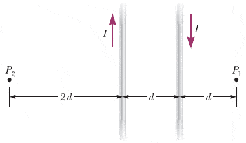

The two wires shown in the figure below are separated by d = 8.0 cm and carry currents of I = 4.85 A in opposite directions.
Diagram of two vertical parallel wires with currents I in opposite directions: left wire up, right wire down. Points P2 and P1 lie left and right, spaced 2d and d from the wires as labeled.
d = 8 cm = 0.08 m
d = 8 cm = 0.08 m
r = 0.08/2 = 0.04 m
2d = 21.6 cm
I (up) = 4.80 A
I (down) = 4.80 A
(a) Find the magnitude and direction of the net magnetic field at a point midway between the wires.
magnitude: ______ µT
direction: ______
(b) Find the magnitude and direction of the net magnetic field at point P1, 8.0 cm to the right of the wire on the right.
direction: ______
(c) Find the magnitude and direction of the net magnetic field at point P2, 2d = 16.0 cm to the left of the wire on the left.
direction: ______

Assume that the wire on the right is wire 1 and that on the left is wire 2. Also, choose the positive direction for the magnetic field to be out of the page and negative into the page.
(a) At the point half way between the two wires,
Bnet = -B1 - B2
Bnet = -[(µI1)2πr1 + (µI2)/2πr2]
Bnet = -(µ/2πr)(I1 + I2)
Bnet = [-(4π x 10-7)/2π(0.04 m)](4.85 + 4.85)
Bnet = (-0.000001257/0.251)(9.7)
Bnet = -0.000012193/0.251
Bnet = -4.85 x 10-5 T
or
Bnet = 48.5 µT into the page
QUESTION: the signs for B1 and B2 changed. WHY? I don't understand!

In addition to TSny's link, make sure you understand the right hand rule, and how the magnetic field of a long wire fits into that.
And lastly, the sign convention used in the solution was stated at the beginning of the solution,
"Also, choose the positive direction for the magnetic field to be out of the page and negative into the page."​
That last part is an arbitrary convention. You could have chosen the opposite convention and let positive be into the page and negative out. You would end up with the same, final answers in the end. The important thing to do here is to pick a convention, and stick with it consistently throughout the problem.

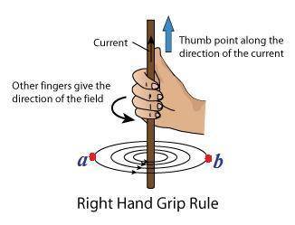

That's the thing though! I have NO idea if the magnetic field is going into the page or out of the page... :(:(
Right Hand Grip Rule diagram: a hand wraps a vertical wire carrying current upward, thumb pointing up along the current, fingers curling counterclockwise to show the circular magnetic field lines around the wire.
That diagram only indicates it going CCW.
Can't I just say this instead?
Magnetic field is going CCW: -B
Magnetic field going CW: +B
At point a in the diagram is the field coming out at you or away from you?
How about at point b?
  • Right Hand Grip Rule diagram: a right hand grips a vertical wire carrying current upward, thumb pointing up along the current, fingers curling around it, with concentric circular field lines around the wire and points a and b marked on either side.
At point a, it's moving away from me. At point b, it's coming out at me.

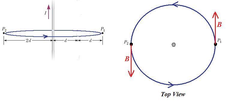

riseofphoenix said:
is that right?
No. You can see the little arrows on the circular magnetic field lines that tell you the direction of the field lines (CCW). Suppose a little bug walked CCW around the circular field line that contains points a and b. When the bug reaches point a would the bug be walking toward you or away from you?
Here's a pic that shows a top view. Note that the field line goes CCW in the top view, but the B field points in opposite directions at P1 and P2.
  • Top view diagram of a circular blue loop with counterclockwise arrows, a gray dot at the center, and red arrows labeled B at points P1 on the right and P2 on the left, pointing in opposite directions.
riseofphoenix said:
Toward me?
Yes, the bug would be walking toward you (out of the page) at point a.
