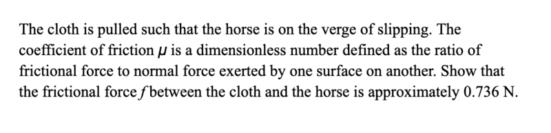

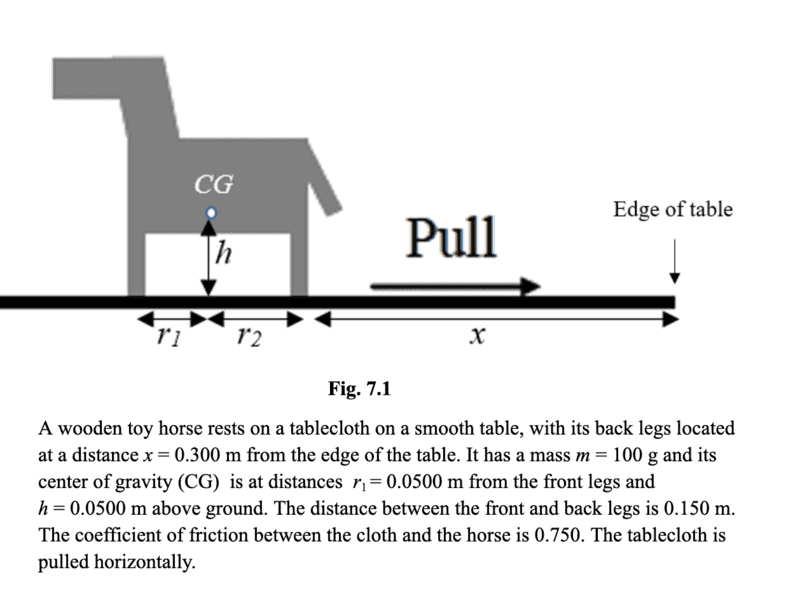

Wld I be right to say that the object does move?
I ask this because this exam question seems to suggest that the Horse (analogous to the object) can somehow remain on the verge of slipping.
We assume that the table/tablecloth interface is frictionless.
[edit: Regarding the horse/tablecoth, what kind of friction are we talking about ? ]
Which means that the leftward static friction force acts on the table cloth along the Horse/cloth interface?
By N3L, a rightward static friction acts on the horse?
