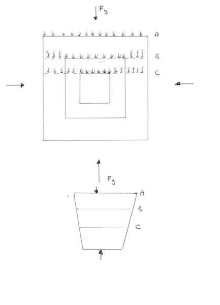

I was thinking about the pressure build up in a system that is squeezed equally from all sides (or at least in two dimensions, like squeezing a tube of toothpaste), and I ran into a conundrum. If the pressure increases as the area decreases, then the pressure inside a circle that's squeezed radially should approach infinity as we approach the center of the circle. I'm attaching a picture to illustrate this. View attachment Pressure Pic.bmp Consider the area as the circumference of the circle - the outside of the tube of toothpaste, for example. As I squeeze it with any force at all, doesn't the pressure (P = F/A) become greater and greater without limit as we consider smaller and smaller inner circles? When I squeeze the tube, why doesn't the lid burst off the toothpaste under billions of Pascals of pressure, or why doesn't a needle-thin stream of toothpaste spray out from the center when the lid's off? What's happening to prevent that? I understand that viscosity will try to limit this, but again, at the very center of the tube, shouldn't the pressure approach infinity?
How can you generate a pressure inside greater than the pressure at which you squeeze?

Pressure is not something you can build up like money in the bank.
It disappears as soon as the applying agent is removed.
Nor does it increase just because you are considering a smaller area.
Pressure = Force/Area
One way to think of pressure is to think of it as a sort of distributed force, ie distributed over an area.
If you cut off (reduce) some of the area) you also remove the force that was distributed over it so the Force term in the equation is also reduced (in the same proportion) and the pressure remains constant.

OK I finally understand your query and its resolution.
It is important to realize that the situation with the nail and my peg is not the same as the ever diminishing test circle you originally described.
The stress (pressure) in tapered peg as shown in my second sketch does indeed increase from section A to section B to section C.
This is because the whole of the applied force is transmitted across each section.
In the first sketch I have shown a limiting process taking ever smaller squares (squares are easier to work with than circles).
I have only shown two dimensions but the same principles apply in 3D.
The important point is that as we move from section A to B to C and select the smaller inner square, less force is transmitted across the section - or rather part section - which comprises the inner square.
I have shown this only on the y axis.
Fy is the total applied force to the outer square.
To calculate the stress we distribute it across the whole of section A, as shown by the line of small straight arrows.
At section B we select the middle square.
Fy is still distributed across the whole of section B, only part is now across our square.
I have shown the missing part as squiggly arrows and the active part as straight arrows as before.
At section C we are missing even more of the distribution of of Fy
At all sections the stress is the same.
Hope this helps
go well
