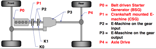

Not read the article properly, but it's not really outside the box anymore. ;)
It's effectively a P1 hybrid architecture.
Can replace the starter, but not the alternator. As you keep the high voltage and low voltage systems separate.
