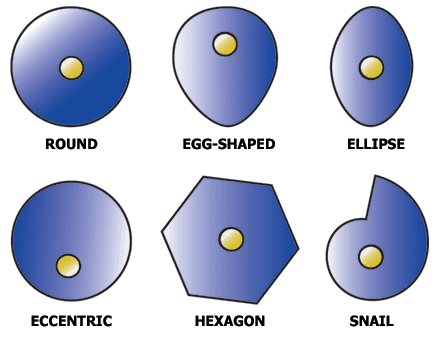

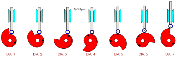

Perhaps a simple 555 timer might be a good place to start. You can simply program it to send or cease a signal after a certain duration, which would elsewhere be determined by the sensor input. There'd be more to it, obviously.
I wonder if that is over-engineering though. Rotating cams might be a more mechanical way to go. They could be made out of any material such as cardboard or plastic, and can be easily programmed - including on-the-fly tweaks, with a deft flick of an exacto knife - to start and stop things, flip switches, release latches, etc.
When I was a young lad, I got a toy car that could be programmed to do all sorts of tricks by inserting one of a series of carefully-configured cams that controlled steering (you could even make your own).
