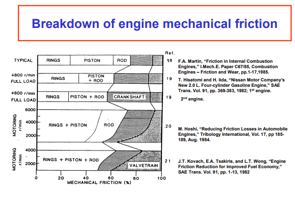

JAlda333 said:
it deserves an in-depth understanding because there is not a single article covering why there is so much energy loss in the piston, rings, and crankshaft.
Actually, there is such an article. It breaks down the total friction of an engine into the various causes. It's a good read because there are causes of friction that are not obvious. Get a copy of SAE paper 640807 titled Effect of Design Variables on Friction and Economy. And it's still available: https://www.sae.org/publications/technical-papers/content/640807/. That link also points to some newer papers on the same subject. One of many graphs in the 640807 paper:
Likes PeterDonis, russ_watters and Dale

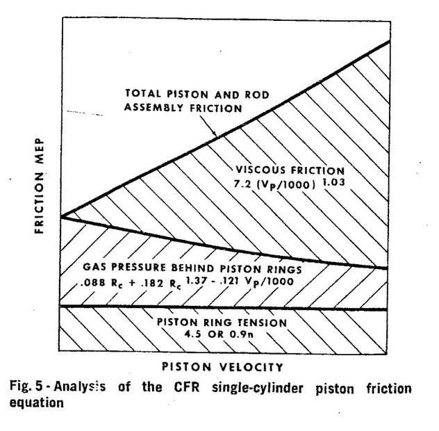

There's a lot of articles and test data available, but I am not able to find any on the piston's kinetic energy that positively identifies it as one of the losses. Here's one more from MIT's Opencourseware Lec. 19:
That's because you are looking for something that does not exist, as was explained in Posts 2, 3, 4, 7, 8, 12, 13, 15, 16, and 18. Yes, the piston speeds up and slows down. The energy to do that comes from and goes into the flywheel. The energy is not converted to heat, it just transfers back and forth between the piston and flywheel as explained in the quote from @Nugatory below:
