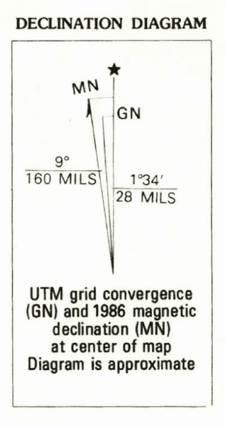

when I look at large scale map such as USGS top maps, i noticed that maps' grid are not aligned with the map frame. looking at the declination diagram at the bottom of the map, there's a difference between true north and GN (Grid north)
can someone explain to me why the map grid doesn't align with True north?

thanks for the reply, i understand the difference bet. true north and magnetic north. the question i have is why the difference between True north and Grid north. please see attached picture USGS top map Declination diagram, there is a difference of 1 deg 34 mins between true north and grid north, can anyone explain this difference?
It has to do with how the surface of an oblate spheroid like the Earth is projected onto a two-dimensional flat surface while minimizing distortion of the geographic features from the three-dimensional surface.

When detailed maps of a region are produced, a central meridian is chosen which usually runs thru the center of the region being depicted. The further away one goes from this central meridian, the more distortion accumulates on the two-dimensional map, so large areas, like the continental United States, are usually split up so that several different reference meridians are used. UTM is a global projection, but the U.S. also has a separate projection system called State Plane, and the 48 continental states plus Alaska and Hawaii are divided into one or more regions for the purpose of making 2-D maps of these territories. In each system, State Plane or UTM, the 2-D map is designed so that features can be located with a pair of X-Y coordinates, with X being measured east and west from the central meridian while Y is measured north and south from a reference latitude. UTM measures X-Y in meters while State Plane uses feet.

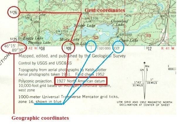

No we're not. Geographic coordinates are very different from grid coordinates. The star in the legend represents geographic north and the GN angle represents the angular difference between geographic and grid coordinates at the center of the sheet. This particular map shows two grids (UTM in blue and 1927 North American).
Also, take a look at this map of an area in northern Russia. You will see that the geographic coordinates actually curve on the map where the grid coordinates do not. For maps at this latitude the angular difference between geographic and grid coordinates varies too much across the sheet to give a single value from the center.

Correction: The line from the 1927 North American datum should be pointed to the 320000 FEET tick between the two blue circles.
