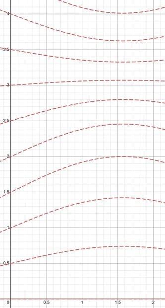

A problematic mapping
Consider $$f(x, T) = \frac {(sin(T) sin(x))} {2} + T = t$$
Here is what the grid for this convention looks like when projected on a normal Minkowski spacetime diagram:
With this convention, one cannot maintain clock synchronization among observers at rest in all cases. Since clocks move at the same rate for observers at rest, once two clocks are synchronized, they will remain synchronized. Logically, this should mean that, after synchronization, matching time values represent simultaneous times for those observers—but the convention says otherwise.
With this convention, it isn't clear that we can establish the one-way speed of light. Do we measure the speed along the main observer's lines of simultaneity for both departure and arrival? Or do we synchronize clocks for when the signal is sent and use the receiver's local time of arrival to determine the speed?
A convention which contradicts physics or creates ambiguities seems like a good candidate for an invalid simultaneity convention.
The convention I chose has other problems: it fails to obey Einstein's first postulate: the choice of an arbitrary 0 time coordinate is significant. Two observers, even with overlapping worldlines, may get different measurements for the one-way speed of the same photon if they choose different 0 time. In general, any convention that allows the one-way speed of light to vary creates unique inertial frames.
The argument for making these conventions invalid is weaker: unique inertial frames exist only within the context of the coordinate chart—there is no way to identify a unique inertial frame without choosing a system that makes that inertial frame unique. Making these conventions invalid is more an aesthetic choice—it keeps the physics cleaner by not implying properties that exist only within that convention.

Freixas said:
Consider f(x,T)=(sin(T)sin(x))2+T=t
Excellent work! Yes, this looks valid to me.
That is correct. Some clocks at rest will be time dilated with respect to these coordinates. This is a (pseudo) gravitational time dilation (with reference to the equivalence principle).
It will be spatially varying.
I haven’t done any of the math, but from your plots it doesn’t seem to present any contradictions or ambiguities.
Yes
That would be a different coordinate chart with a different coordinate transform. We would not expect the same one way speeds.
Yes. You cannot really make them invalid, but you certainly can choose not to use them. You don’t need any particular justification for that aesthetic choice.

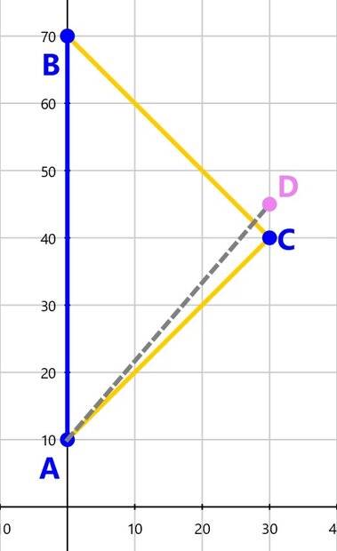

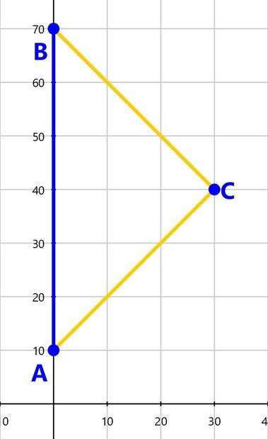

Thinking further, I came up with a scenario in which I did not have to be home at all. I'm at work. I call my wife at home and leave a message. Later, she calls me and tells me that she received my message and that, sometime after hearing it, the dog escaped. At least one event on my worldline from the time I left the message to the time I received my wife's call must be simultaneous with the escape of the dog.
Formalizing this, I send a light pulse to some distant location, where it is reflected back to me. The event corresponding to the reflection of the pulse must be simultaneous to some event on my worldline from the time I sent the pulse to the time I received the reflection.
Any simultaneity convention in which this is not true would seem to violate our concept of simultaneity. I sketched out a diagram of the situation. It appears to me that any such convention would have timelike curves between events.
The usual argument is that conventions with timelike curves between simultaneous events can make events on some observer's worldline simultaneously. This has always seemed to me like a weak objection since we are only talking about coordinates assigned by one observer for another observer's worldline. The observer on whose worldline these events occur would not perceive the events as simultaneous.
As a causality problem, the only rule one has to maintain is that no observer can observer an effect before its cause. Conventions with timelike curves between events don't violate this.
The argument that I've presented here seems much stronger--the conventions violate our standard concept of simultaneity. (Try telling someone that their dog's escape did not occur sometime between their departure and return.)
My approach here does not apply to events connected by lightlike curves. however.
That's the "spacelike requirement". You see this, when you draw the light cone for the reflection event. I don't understand, what your problem is.
My statement "The event corresponding to the reflection of the pulse must be simultaneous to some event on my worldline from the time I sent the pulse to the time I received the reflection," implies that there must be at least one event on my worldline that is spacelike or lightlike connected to the reflection event.
In any case, what I am trying to say (right or wrong) is that , in this case, any simultaneity convention in which no events on my worldline are spacelike or lightlike connected to the reflection event violates my concept of simultaneity (and my concept may also be wrong).
As @Nugatory said, the condition for defined simultaneity is a spacelike (not light-like) separation when using non-perverse coordinates.

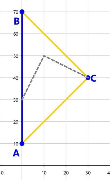

I've been hanging out in the forum long enough that I think I actually know what you're getting at. But I started out by thinking about how I might explain this lack of usefulness of simultaneity to lay people. That led me to think that even though I can't declare any two events to be simultaneous in any absolute way, I might be able to put some bounds on which events might be simultaneous based on how people think about simultaneity.
If I leave home and return to find my dog escaped, people would normally accept that the escape happened sometime during the time I was away. It would be incomprehensible for the dog to have escaped before I left or after I arrived, given that the dog was present when I left and missing when I returned. I then generalized this idea to the reflection example. This seems to me to be a clearer argument for making simultaneity conventions with timelike events invalid.
The usual argument against timelike curves connecting simultaneous events is harder for me to follow. Here's what that argument sounds like to me: "You can't have two events on any worldline be simultaneous." "Why?" "Because they can't." "Why?" "Because they are different events." "So?" "Well, you can't toss a ball and catch it at the same time, right?" "No one is tossing a ball and catching it at the same time--someone else has just assigned the same time coordinate to the two events. The person tossing and catching would not use these coordinates. In fact, even the person who assigned the coordinates will never actually observe the toss and the catch happening simultaneously--they only calculate these to be simultaneous events based on their coordinate system choice."
Maybe I need a clearer definition of perverse and non-perverse.
My own argument may be making a case that timelike simultaneity is "perverse" in the sense of a lay person's idea of simultaneity. I'll repeat the example of "perversion" I just used in my reply to Nugatory: "If I leave home and return to find my dog escaped, people would normally accept that the escape happened sometime during the time I was away. It would be incomprehensible for the dog to have escaped before I left or after I arrived, given that the dog was present when I left and missing when I returned."
Unfortunately, when generalized to the example where I bounce a light pulse, I can't exclude lightlike simultaneity without a priori defining it to be forbidden. I could disallow light traveling instantaneously in one direction, which would solve the problem, but would introduce the question "Why?" When I asked in a previous discussion, the answer was that you can't have emission and reception be simultaneous, which sounds like a circular argument.
I already gave it to you, way back in post #2: you don't want events that are causally connected to be simultaneous. The events of emission and reception of a light ray are causally connected, so in any non-perverse coordinates they will not be simultaneous.

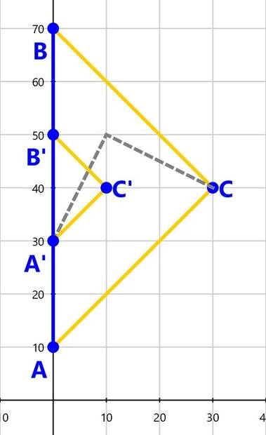

It's just not clear why this [events that are causally connected to be simultaneous] is something I "don't want".
That would mean that the cause and the effect have the same time coordinate even though they are spatially separated, and therefore that the effect is propagating with an infinite coordinate speed. That will definitely get in the way of understanding the physics at work in this interaction. @PeterDonis says "definitely don't want that", I say choosing that would be "perverse".
Dale said:
we can easily show that along any timelike worldline is strictly increasing
Or any null worldline. The condition that simultaneity surfaces must be spacelike prevents any pair of events that are not spacelike separated from having the same ##t## coordinate.
