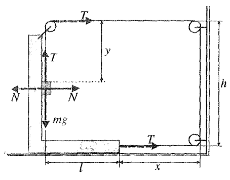

Find accelerations of the two bodies.
Constant rope length.
Hi, I've been practicing some physics for my competition and the pulley problems seemed the hardest to me. This one seemed similar to the others I have already done, but I can't seem to find the reason why 2Δx = Δy. Can you please explain why?
Sorry for the poor English.
Diagram of a pulley system: a block on a horizontal surface connected by a rope over pulleys to a vertical block with forces T, N, and mg labelled; lengths l, x, h and y are marked.
What happens if you draw another picture showing the situation after the system has changed by ##\Delta x##?

What I do is draw the setup with a visible ##\Delta x## (e.g. half-way to the wall) and then I check which pieces of rope have changed length.
You also have to worry about signs. Which way is positive in x and y ?

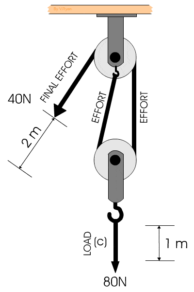

UniqUnicJohni said:
... This one seemed similar to the others I have already done, but I can't seem to find the reason why 2Δx = Δy.
All pulleys look alike, but some serve only for changing the direction of the rope/cable/chain, while others act as levers, reducing the pulling effort in half and doubling the length of rope to pull.
Try identifying what type each of the pulleys in your diagram is.

Very nice picture !
