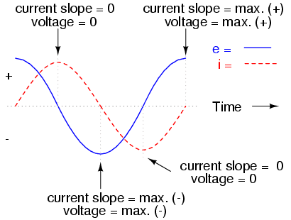

What i know the most fundamental thing is that the emf supplies energy to the charges and these charges have to reach the other end(say for electrons to reach the + end). IN order to do that somehow or the other they have to drop their voltage or energy for this to happen .
AC with inductor alone
In inductor the thing which drops the voltage is the induced electric field acting to oppose the electrons to flow.OK all this fine i understand.
But in the figure below when the inductor voltage or when the induced electric field(which is generated by the changing magnetic field) becomes 0 or when the current becomes quite constant then no induced electric field as a result there won't be a voltage drop there then how can current be maximum when there is no voltage drop there since the current to reach the other end (+). what i expected that when this induced electric field is zero there won't be any voltage drops as a result current should not flow but it is maximum at that time.
PLZ any 1 if i can understand this most of my problems are over
PLZ don't explain with water analogy.It works for water analogy even i know that but here it is not working.pLZ explain in a more theoretical way than mathematical

Are you familiar with the differential equation that relates the voltage drop across an inductor to the change in the current through the inductor?
[tex]V(t) = L \frac{dI(t)}{dt}[/tex]

k i have posted the image
atleast now give the answer because i need it desperately

Dear Sudar,
Here's the edited post;
Your doubt is not uncommon. The problem is, nature acts in more mysterious ways than what is obviously evident. Collapsing of a magnetic field and building up of emf or electrical charges is a gradual process and is governed by the laws of nature. A magnetic field cannot suddenly collapse or build up at time t = 0. Any physical reaction consumes some finite amount of time although it would be infinitesimally small and could be neglected in theory.
One more important thing to note is that the voltage vs. current waveforms normally depicted are not relevant in actual practice. For example as soon as you throw the switch on a pure inductor, the voltage and current will never become 90 Deg out of phase immediately, i.e., at t = 0. To do that, it will take some finite amount of time, which is normally not depicted in waveforms (such as the one appended by yourself) for reasons of simplicity.

A) To visualize the concept of inductance is pretty difficult. I have been dabbling with it for quite sometime now! In order to explain you the working of an ‘ideal’ inductor, I will have to make certain assumptions;
1) the coil of inductor should possesses zero resistance
2) The inductor should have a magnetic material core (iron, ferrite, etc…. but not air-core). In an air-core inductor, the voltage and current waveforms will be practically in-phase with each other thus defeating the purpose.
3) The magnetic core should be ‘Lossless’
4) The input voltage to the ideal inductor is purely sinusoidal.
The voltage and current waveforms do not immediately phase shift by 90 deg as depicted by textbook diagrams. Consider positive half cycle of ‘voltage versus current’ waveform for an ideal inductor. At ‘t (time)’ = 0, as the voltage wave just rises above zero, the current wave rises in-phase with it. However as the voltage wave further progresses at ‘t (time)’ > 0 towards it’s peak value, the rate of change of magnetic flux becomes more pronounced ad the current wave now starts going out of phase w.r.t the voltage wave. Eventually as the cycle progresses, the current wave now completely goes 90 deg out of phase w.r.t the voltage wave (assuming an ideal inductor).
If you concentrate on the negative half cycle of the voltage vs. current waveform, you will find that the phase shifting is due to the ‘discharge’ of electrical energy by the inductor back to the power source as the magnetic field collapses (or rises, whatever may be the case), which precisely occurs when the input voltage wave has already reversed itself. This charge/discharge action of an inductor occurs due to the finite time taken my the magnetic field to rise or collapse……as force fields cannot change it’s states abruptly at ‘t = 0’ as per the laws of Physics or Mother Nature (if it would, the consequences would be disastrous). This in turn causes a delay in the flow of current thru the inductor and results in the phase shift between the voltage and current waveform. This delaying property of an inductance is also sometimes known as ‘Magnetic Inertia’.
