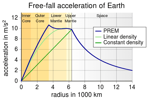

Does this look like a constant to you?

A.T., I confess that your chart is not clear to me. Could you elucidate?

That said, can you state the context of your disagreement? The acceleration due to gravity certainly depends on altitude (see A.T.'s chart), but for most practical purposes can be considered constant over short distances from the earth.
