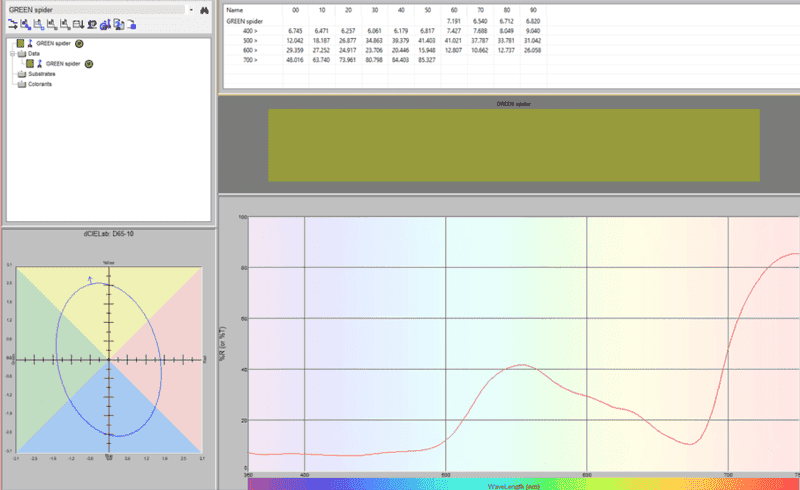

If you look into how colour comes about you will see it is just about what is absorbed and what is reflected in terms of wavelengths. That depends on the molecule. 'Green' in terms of the the colour we see will not be just a peak at 550nm if you measure it you will see a spread of different wavelengths. In fact I will stick a leaf in the spectro next week and post it here. Edit @fresh already posted a link but I will still do the measurement.

As promised, a spider leaf measurement showing spectral reflectance data BETWEEN 400-750nm
This does not tell us much about the chemistry just that there are molecules there that absorb blue and reflect green and some yellow and red.
