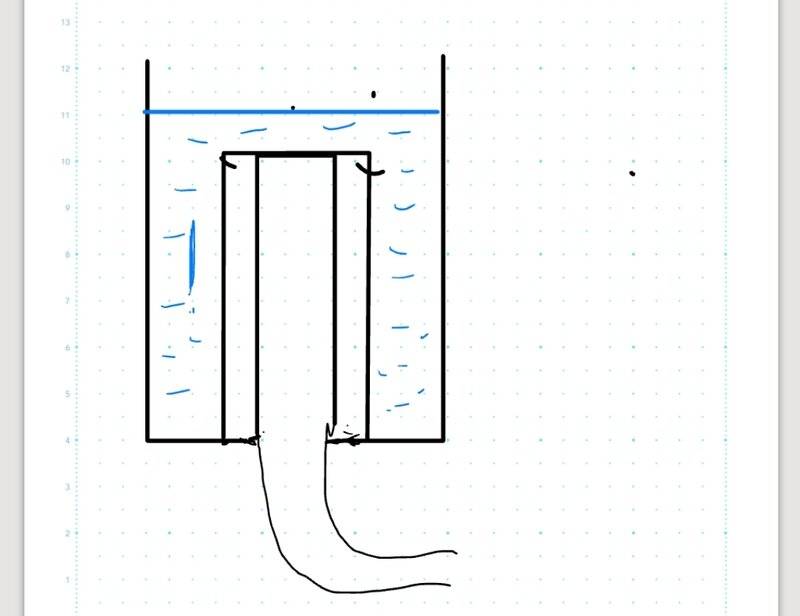

What is the reason for placing the spirometer at 400mL mark at the start of the experiment?
NA

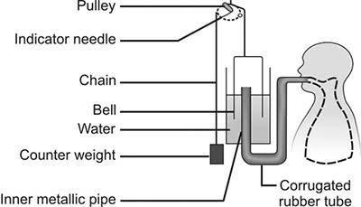

This is a water spirometer. You have to exhale as hard as possible the pulley rotates and the pointer shows the volume exhaled.
The procedure wants us to keep the pointer at 400 and later subtract 400 to get the correct volume.
Why can't we start at zero?
Teacher says it is easier to exhale when there's more air. As far as I know, the role of water is to only act as an air tight seal.
And I don't see why more air makes any difference in resistance to expansion. We have to always blow against air pressure anyways?

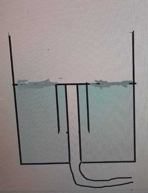

Aurelius120 said:
But how does it change anything? Less air or more air in inner cylinder shouldn't change resistance, right? I still have to exhale against atmospheric pressure.
If it's at zero, then it can't form a proper seal. Air could escape, ruining the calibration.
I think (without being 100% sure) that "zero" means that the bell is all the way down with its bottom just above water level. OP is asking why one cannot start at this initial position in which case the amount of air that one blows in is what the indicator points.
Which means that the bell will not float and, therefore, the indicator needle will be unreliable.
With positive buoyancy, the apparatus has a stable equilibrium point.
Why would it be unreliable?
Because we have to blow air against mass of bell which would make it difficult to exhale all air??
If the inverted jar sinks to the bottom, the pointer will spin as it does so. The pointer is where you measure the results, right? You want to measure the volume of exhaled air, not the depth of the tank.
jbriggs444 said:
If the inverted jar sinks to the bottom, the pointer will spin as it does so. The pointer is where you measure the results, right? You want to measure the volume of exhaled air, not the depth of ri3the tank.
But if it is at zero when the bell is resting at the water level,bell can't sink any further? Blowing air into it will still make it float, and give the required reading right?

I meant this. (Water level at level of bell and bell resting on air pipe)
Since normal reaction is balancing the bell. We have to blow against (weight-buoyancy), Right?
Similar to if we had to lift/move a metal block with only force of exhaled air?
Similar to if we had to lift/move the bell with only force of exhaled air?
That sounds like you understand the mechanics. You would have to generate some net pressure over the area of the tube to get ##N## (the normal support from the pipe) to go to zero. That pressure would depend on the tube area and the material density of the bell. It could be that the bell is just barely touching the tube end (bell made of plastic or something of low density), or maybe it's a steel bell with high density and large weight.
Weight of what and buoyancy of what, exactly?
In the initial state, I see an inverted beaker supported by nothing other than the rim of the vertical pipe.
The upward pressure of water on the flat upper surface is exactly equal to the downward pressure from the atmosphere. The upward pressure of the air in the pipe is exactly equal to the upward pressure from the air in the pipe. Zero net upward force from buoyancy on the bulk volume of the beaker.
We do have some buoyancy from the upward pressure of water on the lower rim of the beaker which is not entirely matched by the downward pressure on the upper rim of the beaker.
So yes, we have the weight of the glass (or metal) beaker minus the buoyancy from the volume of the beaker's glass (or metal) in water. A beaker made of ordinary glass or from borosilicate will have a specific gravity of about 2.4 or 2.5. Stainless steel is three times that.
So for a glass beaker, it would be about 60% as hard as blowing against the same beaker resting on top of the vertical pipe with an airtight seal but no water. (##\frac{2.4 - 1.0}{2.4} \approx 0.6)##. For a stainless steel beaker it would be about 87% as hard as blowing against the same beaker resting on top of the vertical pipe with an airtight seal but no water (##\frac{7.5-1.0}{7.5} \approx 0.87)##
The diameter of the pipe will be a critical factor in how much air pressure we will need to do this.
If the seal is leaky, we may be able to introduce air more easily than that. The diameter of the beaker will then become important.
