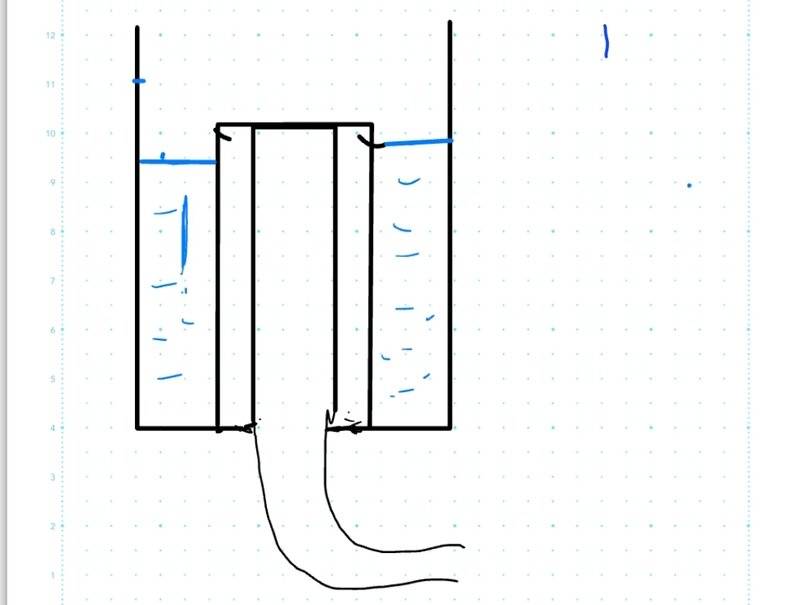

What I meant is that
I have to blow against atmospheric pressure but
But here I have to blow against water pressure.
I think I am making a mistake but I can't figure it.

  • #34
DaveC426913 said:
How do you know blowing air will make it float? In order for that to be true, the Bell jar must already be neutrally buoyant, which it is not, because it is resting on the bottom.
Was he trying to say something different than the pictures I posted?
I think I have made a mistake.
  • #35
OK. let's look at your diagrams for a moment.
  • The bell is resting on the bottom of the reservoir.
  • How much weight is it applying there? What if it weighs - say, for the sake of argument - five pounds?
  • If the patient blows into the tube, they're going to have to compensate for five pounds of weight before the bell even lifts off the bottom!
  • If they can only manage four and a half pounds of pressure, the device will remain registered at zero.
Implications:
  • The bell must be nuetrally buoyant.
  • It must float somwhere in the middle - 400mL is as good a place as any, and it abides by a universal standard
  • #36
Oops.
Aurelius120 said:
What I meant is thatView attachment 357419
Yes this was my mistake.
Implications:
The second diagram I drew as the source of error like you were saying.
