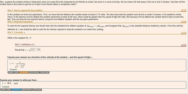

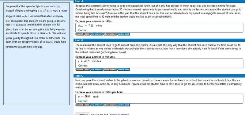

Screenshot of an online physics homework page with a left panel of problem text about light speed and time dilation, and right panels Part A, Part B and Part C with submitted answers marked Correct: d_max = 7.50 miles, t = 49.9 minutes, v = 36.6 mph.
this is the hint for part C
Online homework screenshot showing hints and a Correct gamma equation gamma = 1/sqrt(1 - (v/c)^2), and a velocity answer of v = 36.6 mph marked Correct.
t=T/(1-(v/c)2)1/2
my attempt.
i know that from the restaurant to school it will take 15 min in school's frame and ice cream melts in 5min in the car riders frame..so i did
(15/60)=(5/60)*(1-(v/c)2)-1/2
so i solved for v and got c=37.74. which was wrong, do not know where I am going wrong.
