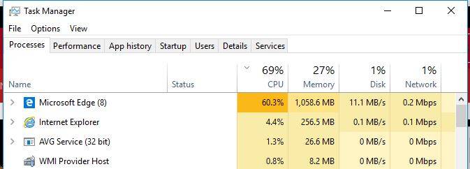

I tried only one web page. Why does Task Manager reports (8)? what does 8 mean? The web page seems to hang.. and heavy usage seems to occur when it hangs..

I tried a second computer.. same result... one page alone can use 60 to 70% of the CPU. You can duplicate it too. go to
http://www.abs-cbnnews.com navigate around the site.. click some links and go back to main page, etc.
Use Microsoft Edge browser that is the default browser in Windows 10.
You can expand the display of child processes which Edge has forked off by clicking on the '>' to the left of the entry in the Task Manager. It gives some names that might tell you what their purpose is.
after avoiding the site or opening it in plain internet explorer (which doesn't have high CPU usage).. no more problems even loading more than 50 pages in Microsoft Edge... in case not many are familiar with Edge.. check this out... https://en.wikipedia.org/wiki/Microsoft_Edge

about the heavy CPU usage of that particular website with Edge.. any theory why?
Site devs usually builds a site to support a few version of some few common browser (with the most common addons and environment). It is actually not too hard to occassionally met some inconveniences. Especially when you push it (30 pages opened in one go feels a bit excessive for me).

AVG reported I have tracking malware (maybe one reason for the slowdown even if only one web page opened.. maybe someone's using my CPU power for processing their task...)... What is the best antivirus or antimalware have you guys encounter (preferably free) that can remove all tracking malware (that can track everything I do in the computer and send the information elsewhere)?
If AVG identified the malware, did it remove it? You should repeat the scan and see if AVG thinks your computer is now clean. (I use Norton. I like it but it is certainly not free.)
It depends totally on the website in question.
Some websites can hog 1.4 gigs of memory and near 100% processor with a single page depending on scripting and other stupid stuff.
Some websites use your processor cycles to mine bitcoins or other distributed computing much like the old SETI program.
Some websites have scripts designed to drag down even the strongest processor in an effort to influence someone to upgrade to newer software. It detects older browsers and bogs them down. Result...you upgrade or avoid the site.
