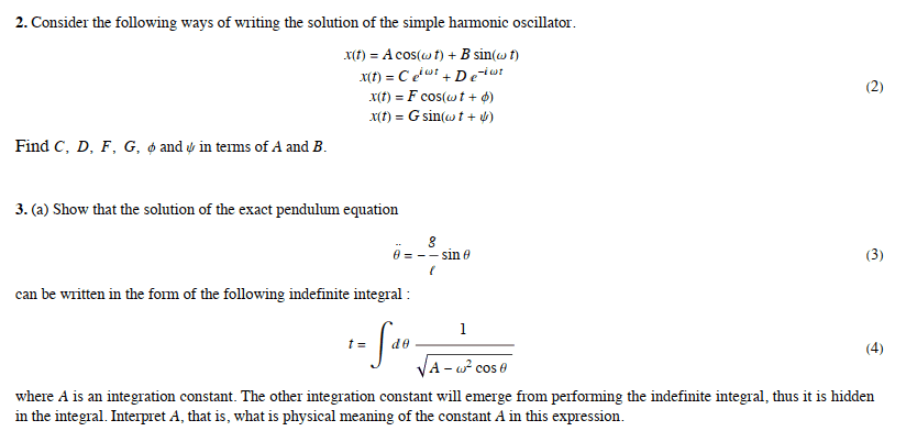

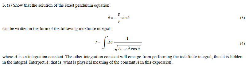

Show that the solution of the exact pendulum equation
can be written in the given form
##\ddot \theta = -\frac{g}{l}sin\theta##
##t = \int d\theta \frac {1}{\sqrt{A-\omega^2 cos\theta}}##
The question is
My attempt is given below
I am not sure what to do now. I don't understand how I can make the coefficient of ##cos\theta## negative.
