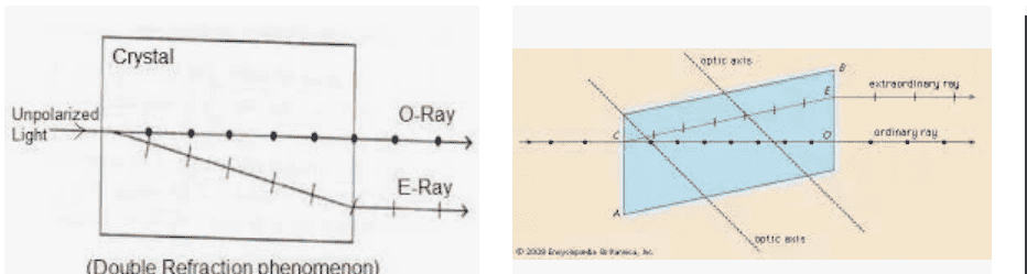

Why is the e-ray sometimes below and sometimes above the o-ray in prisms?

Draw the ray and find diverged angle
Snell law (attached below)
Snell's law:
I am confused why sometimes the e-ray is below and sometimes above the o-ray? how if no>ne and how to
