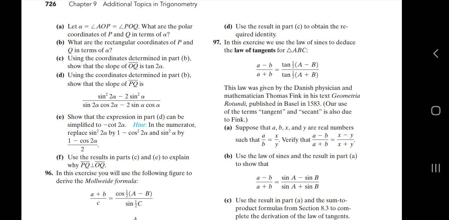

PrecalculusWithUnit-CircleTrigonometry4e2006CohenLeeSkylar,page726

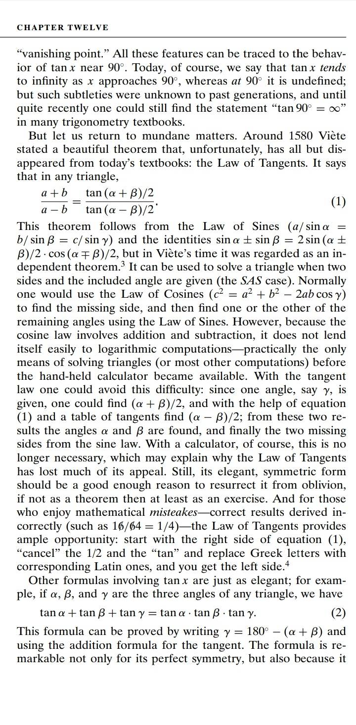

TrigonometricDelights1998EliMaor,page152

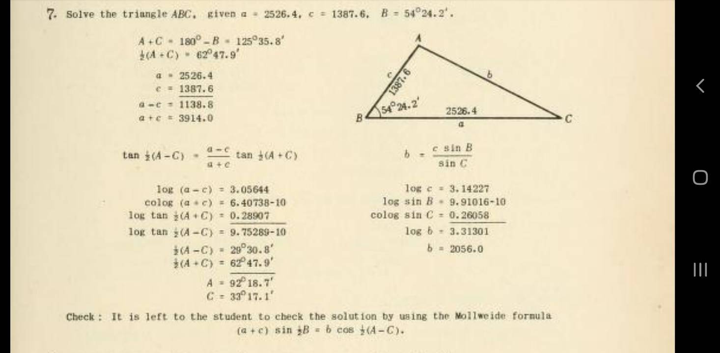

Scaum'sOutlineOfTheory&ProblemsOfPlane&SphericalTrigonometry1954FrankAyres,Jr.,page105
Scaum'sOutlineOfTheory&ProblemsOfPlane&SphericalTrigonometry1954FrankAyres,Jr.,page105.jpg
Now that you've seen what it looks like using tables, would you actually care to have a go at it using your calculator? Ah yes, I forget. You're that passionate math hobbyist who keeps posting math problems but doesn't own a calculator. Or was that your other split personality harpazzo. It's getting hard to keep track of your split personalities.
At any rate, if you do finally get a calculator, you need but note that A + B + C = 180° and you're basically done. A bit of creative thinking and blind application of the Tangent law formula should satisfy your wandering curiosity.
