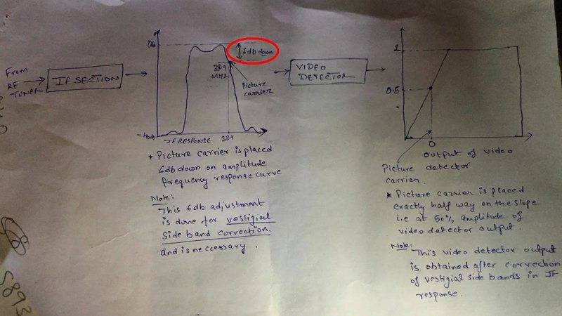

Hi folks,
My query is that...
As one can see that in the IF response curve the picture carrier is placed 6db down the amplitude curve. Such a placement modifies the output of video detector in such a way that the picture carrier lies at half point or 50 % of the total amplitude.
Now this whole story is about VSB correction. I wonder what exactly goes inside the video detector that making a 6db adjustment of picture carrier in IF response curve shapes the output of video detector this way.
What so special about this 6db..?
Please be specific..
The output of the sideband filter gives 50 percent of the gain at picture carrier frequency.
First i want to ask where is the sideband filter is located. either is it in the IF amplifier(IF section) or the video detector..
Let me answer this ...it is located in the video detector as per my present understanding. why i say so is that in my diagram you can see that the picture carrier in the IF output is at 38.9 Mhz where I have marked it 6dB,at this point there the amplitude is not half..Its the video detector that is yielding half the gain at picture carrier.
however your figure makes me feel that the sideband filter is located in the IF section or can say is an IF filter. Please could you clear it out.

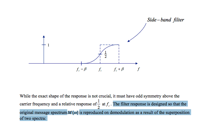

It is at the Transmitter. Since there is identical information in the two sidebands, there is no need to use spectrum space or transmit power to send both of them.
You mean to say that the entire vestigial side band correction is done in the transmitter not in the receiver nor in the IF section..
Not at all. I'm saying that one sideband is not completely suppressed at the transmitter (making it vestigial) to supply a make-up signal to the receiver. Then the receiver, not having a perfectly steep-sided passband, passes the main sideband and the remaining bit of the suppressed sideband to the detector. The detector automatically combines the two sidebands, filling in the main signal that is on the slope of the I.F. passband.
The alternative would be to tune the receiver I.F. to pass all the video frequencies to the detector. But since the passband doesn't have absolutely vertical sides, other interfering signals could get thru, which means the TV channel spacing would have to be wider to avoid interference.

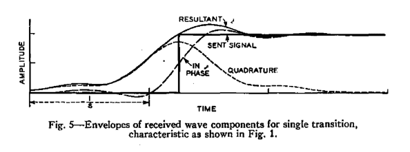

sophiecentaur said:
But the demodulated high frequency video would have phase error because the single side band component is in quadrature with the carrier. Edges would have fringes along them.
When we try to suppress lsb in vsb transmission what causes the envelop of demodulated lsb to suffer phase distortion...? I am visualising quadrature distortion like that some of the lsb frequency is in phase with the picture carrier and that portion of the lab is called inphase component and that component aka that lsb frequency which is in quadrature with the picture carrier is known as quadrature component. So this quadrature component when passed to the envelop detector while demodulation gives improper detection as shown by the figure.
Now the thing which i am not getting is that at the start of lsb suppression in vsb transmission causes the generation of this quadrature component which further contaminate proper demodulation. Why this quadrature component gets generated..??
text source:
Effect of the Quadrature Component in Single Sideband Transmission by Nyquist, H., Pfleger, K. W.
