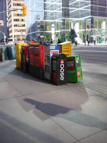

See attached, a picture I took downtown of two different-coloured, overlapping shadows.
Feel free to continue to claim it's a matter of perception. :biggrin:
http://www.davesbrain.ca/miscpix/PF060904shadows.jpg"

I have no idea what you are trying to show with this image,
There are several shadows in the picture. They are of different colours. They are different because they are cast by different-coloured light sources. The bluer shadow is cast by red light coming from red reflective building. The redder shadow is cast by the bluer light off a silver-mirrored building, which is reflecting the blue sky.
This is not matter of perception. It is the same principle as the OP is asking about.
How this applies to the OP's question is that his yellower finger really IS lit by yellower light.

and I don't understand how it relates to the topic. What the camera captures is irrelivant, we still use out eyes to interpet the image.
You are ramming your pre-conceived conclusion down the OP's throat. The OP wants to know why his finger is yellow. Everyone is telling him it's his perception. I am showing that the phenomenon he asks about can be captured, objectively by a camera. It is not simply about our eyes or perception.
