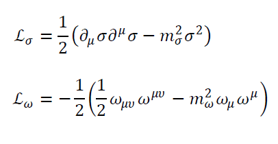

Why is there a -1/2 in the Lagrangian density for ω mesons?

My question is why there is -1/2 for ω meson?
Where did you find these lagrangians?
I would remove the (-)1/2( ...) bit.
Then it can be correct if σ is complex and ω is real valued.
No, you shouldn't remove the ##-1/2## ;-), because it's correct. You obviously work in the east-coast metric, where ##(\eta_{\mu \nu})=\mathrm{diag}(1,-1,-1,-1)##. The physical degrees of freedom of ##\omega^{\mu}## are three space like vectors, and thus to get the right sign for the kinetic and the mass term there must be that additional - sign.
