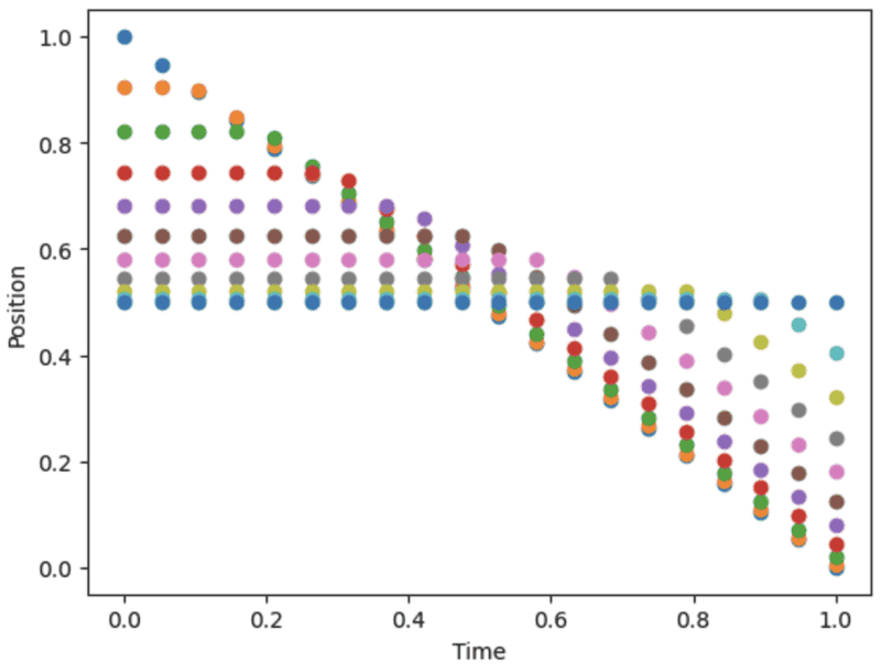

The solution will look like this:
Scatter plot of position against time for 11 points along a slinky, showing points falling from the top toward zero while the bottom point stays at 0.5, with time from 0 to 1.
I have here plotted the positions of 11 points along the slinky (each interval between them representing 1/10 of the slinky) at consecutive time points. Note how the lower point remains in place for the full duration (units are scaled so the time for the wave to reach the bottom is normalised to 1, as is the slinky length at ##t = 0##).
The main observation however is that this is not really what we observe from a real slinky. The top point passes all other points on the way down in this solution. This does not typically happen for a real slinky if you watch the video. Instead, the top collides rather inelastically with the rest of the slinky and this is not captured by the model.

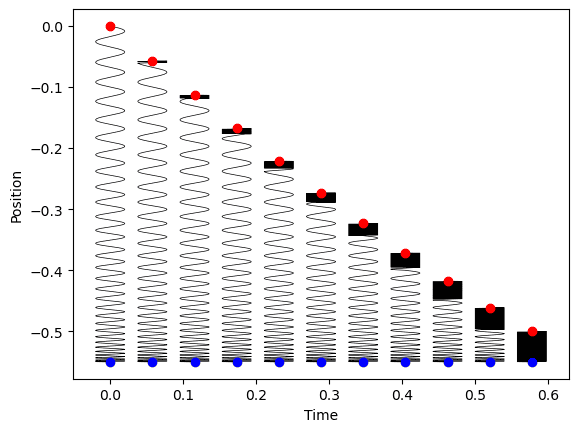

I also played around a bit with my Python script for the illustrations. Here is the model of the slinky drop in the inelastic model (compare to the slow motion capture of any slinky drop):
Plot of position against time showing a spring of stacked coil segments collapsing downward; red dots mark the top position and blue dots the bottom at each time step.
(I added a non-zero rest length to the slinky for visual effect.)

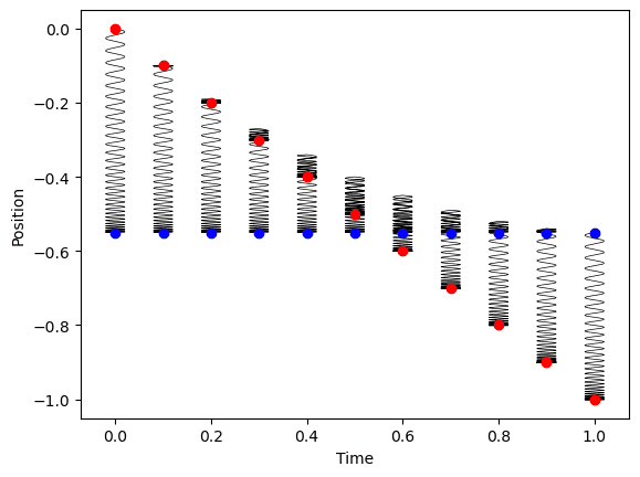

The red and blue dots represent the top and bottom of the slinky, respectively. I used it to easier see how they moved in the original model with only a propagating wave:
Plot of position against time for a hanging spring at ten-hundredths intervals from 0 to 1, with red and blue markers showing the bottom end and the moving end; the spring compresses and descends toward -1.0.
