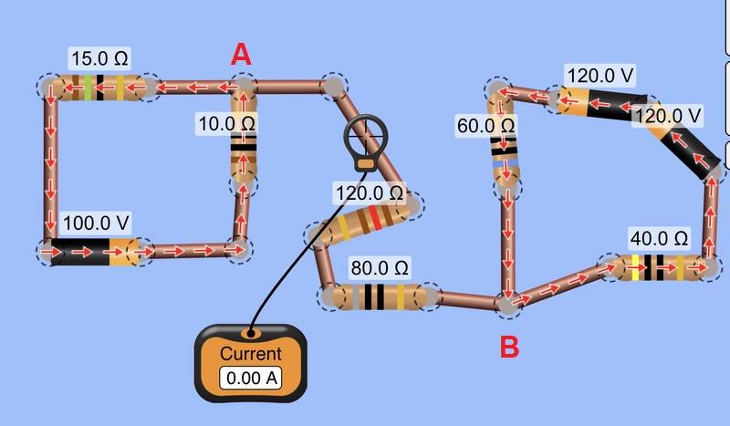

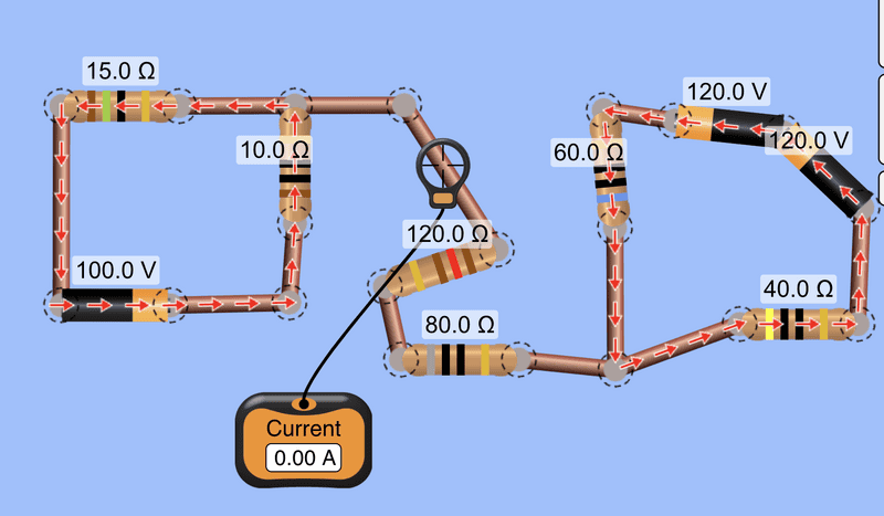

Why is there no current flow in the middle branch? (Circuits problem)
8 replies · 1K views · last reply
phantomvommand
287
39
See picture below
Kirchoff's Laws
PhET-style circuit simulation with resistors labelled 15.0 Ω, 10.0 Ω, 100.0 V, 120.0 V, 60.0 Ω, 40.0 Ω, 120.0 Ω and 80.0 Ω, with red arrows showing current direction and an ammeter reading 0.00 A in the middle branch.
Why does current not split into the middle junction? I notice that this is true regardless of the values of the resistors.

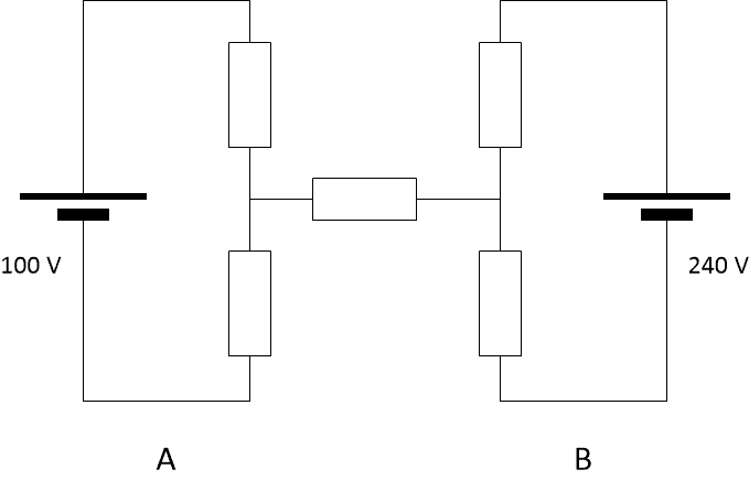

To see why not, draw a more conventional schematic, and check the voltage difference over the 80 + 120 Ohm.
The only reason could be that there is zero potential difference between nodes (junctions) A and B.
Circuit simulation screenshot with resistors of 15.0, 10.0, 100.0, 120.0, 80.0, 60.0 and 40.0 ohms, voltage sources of 100.0 V and 120.0 V, nodes labelled A and B, and an ammeter reading 0.00 A in the middle branch.
In any circuit current has to be able to flow around a loop to return to each location. U-turns don't count, it has to flow in a single direction through each branch. Otherwise the charges would all collect at the end.
<sigh>
We can provide advice, but if he won't take it, he won't take it.
phantomvommand said:
Homework Statement: See picture below
Relevant Equations: Kirchoff's Laws
Because there is nothing attracting the electrons to go that way; and even if there was, there is no way the electrons could get back to their source.
Tom.G said:
Because there is nothing attracting the electrons to go that way; end even if there was, there is no way the electrons could get back to their source.
Which a proper drawing would have shown.
I'd just add that applying Kirchoff Current Law (KCL) to a "cut" around A-B link (that includes it alone) gives zero current through it.
