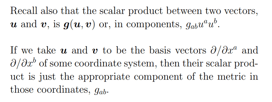

I dont understand why this is true generally. I can see it in Euclidean space, but this is for a general manifold.
"their scalar product is..." why?

At the moment I don't think anything, and its Maths, not what people think. This is a lecture notes so I assume its correct. But I don't see where it comes from, I.e. Why its true
Even for euclidean space i see it intuitively not mathematically

Write ##\mathbf{u}## and ##\mathbf{v}## in terms of the basis vectors ##\left\{ \partial / \partial x^\mu \right\} ##, and substitute these expressions into ##g \left( \mathbf{u} , \mathbf{v} \right)##.
A little nitpicking about terminology. There is no "general manifold" statement really accurate.
The sensible way to make the scalar product of ##\mathbb{R}^n## "more general" is to consider manifolds with metric, aka (pseudo-)Riemann-ian manifolds. A general manifold needn't have a metric.
