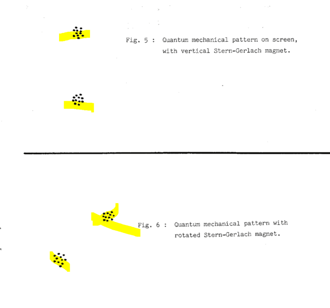

Here is a relatively accessible paper that explains exactly in what way your specific analogy fails. Basically, if there is some “hidden variable” then the probability laws can be written in a specific form and that form constrains the possible probabilities. Actual QM experiments violate that constraint, so there can not be any such “hidden variable”.
https://cds.cern.ch/record/142461/files/198009299.pdf
Thanks I will read it. Hopefully it answers it.
Unfortunately it did not help me. You can't logically separate these two explanations of the state before measurement:
- two un-measured un-determined entanglemed spins (quantum explanation)
- two un-measured yet set-at-entanglement spins, (my explanation)
They are both logically equivalent and experimentally equivalent upon measurement. so you can't break that simple logic no matter what experiment you try to create.
Can someone please help a bit further? I swear I am proving action at a distance at least un-provable here?
