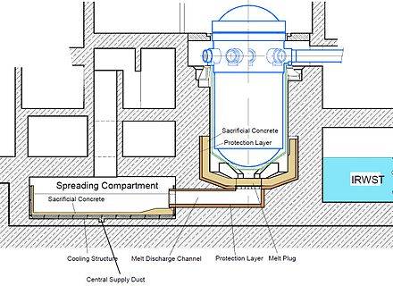

That is still not the maximal temperature of damaged fuel. If it stays contained (without cooling to balance heat production) in narrow space the temperature will keep climbing indefinitely.
The actual approach is to dilute and scatter the molten fuel (google up 'core catcher').

Interesting, thanks @Rive -- I hadn't heard of that either.
https://en.wikipedia.org/wiki/Core_catcher

That's fascinating! Now my question is whether or not this has been tested and proven to work. How would one test a system such as this without initiating a meltdown? (Which honestly seems counterproductive, and the risks involved seem to outweigh the reward...) Is this system mandatory in 'new' nuclear reactors?

Regarding ex-vessel "core catcher" this was considered by the US regulators in the 1960s. David Okrent's book goes into this in some detail. See NRC ADAMS website, search for accession number ML090630275, "On The History of the Evolution of Light Water Reactor Safety in the United States".
https://www.nrc.gov/docs/ML0906/ML090630275.html
By the way, this document is fascinating if you have an interest in the history of nuclear regulations in the US. But be warned it is over 1000 pages.
