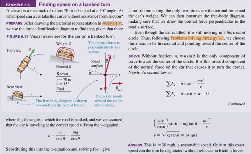

Why isolate n in the x-component for finding speed on a banked turn?
1 reply · 1K views · last reply
aron silvester
The question wants us to find the velocity that the car can take without assistance from friction. The friction, in this case, is the normal friction, weight friction, and the static friction (pointing towards the right). I understand how it got ncos(15) - w = 0 for the y component. What I don’t understand is why do we need to isolate n, which equaled to mg/cos(15), and plug that inside the n for the x-component?
Textbook figure of a car on a banked turn: top view with velocity and radius, free-body diagram from behind showing weight, normal force at 15 degrees, and net force toward the center, with a known-values box.
[/B]
It's all in part 1
It's all in part 1
Because you have a system of two equations and two unknowns, n and v. You eliminate n in order to solve for v.
