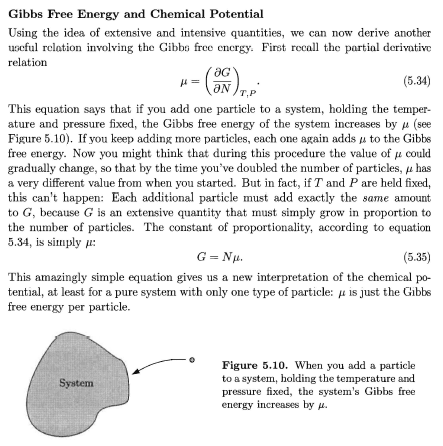

In the textbook Thermal Physics by Daniel Schroeder he says the following:
However, I don't follow this argument. Let's say that G was the following:
$$G(T, P, N) = (TPN)^{1/3}$$
Then
$$G(\lambda T, \lambda P, \lambda N) = \lambda G$$
So $$G$$ is extensive, but $$G \not \propto N.$$

In this example ##G## is not extensive since ##G(T,P,\lambda N)\ne \lambda G(T,P,N)##

Isn't the definition of extensive
$$Q(\lambda q_1, \lambda q_2, ..., \lambda q_n ) = \lambda Q(q_1, q_2, ..., q_n)?$$

The ##q_i## need to be extensive here. You are looking at ##P## and ##T## which are intensive. If you double the amount of stuff, temperature and pressure don't double. Have a look at the rabbits on the page before the excerpt you used in the OP.

No, you have to multiply only the extensive variables with ##\lambda##. The intensive variables don't change when scaling the "system size". That's the definition of extensive vs. intensive variables.
