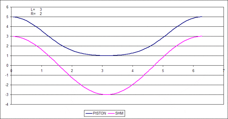

Just look at the definition of SHM vs. that of a piston with a connecting rod. I attached a basic Excel spreadsheet that allows you to play with the values of L (connecting rod length) and R (crank radius). As you make L larger you can see the displacement curve for the piston approach that of the SHM curve.

  • Line graph of two curves against angle from 0 to 7 radians: PISTON (dark blue) falls from 5 to a minimum of about 1 near 3 and rises back to 5, while SHM (magenta) falls from 3 to about -3 and rises back to 3. Labels read L = 3, R = 2.

SHM has to follow sinusodal motion.
Real rods have a 'dwell' time that is affcted by the Rod /length to Crank Throw Ratio. (L/R) This is where the crank and conrod are still rotating, but is not piston up and down.
The lower the ratio the longer the dwell time at bdc and tdc (the teo have different values and the majority of dwell is at bdc). As the ratio increased the dwell time reduces, making the shape of the dixplacement against crank angle curve become closer to sinusodal.
When you start getting L/R ratios of 6+ you can assume that the conrod is following sinusodal motion.
In real engines this means you have to go back to pre WW2 engines. After the war L/R ratios began to reduce. Typical engines now run an L/R ratio between 1.5 and 3.
With that sort of ratio, if you want accurate answers, you can't assume shm.
