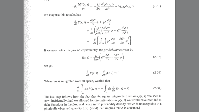

Q1. Why is the probability current ##j(x,t)=0## at ##x=\pm\infty##? (See first line of last paragraph below.)
My attempt at explaining is as follows:
For square-integrable functions, at ##x=\pm\infty##, ##\psi=0## and hence ##\psi^*=0##, while ##\frac{\partial\psi}{\partial x}## and hence ##\frac{\partial\psi^*}{\partial x}## must remain finite for ##\psi## to be differentiable, a requirement for it to be a solution of the Schrödinger's equation. Hence by (2-32), ##j(x,t)=\frac{\hbar}{2im}(0-0)=0##.
But more rigorously, we should say as ##x\to\pm\infty##, ##\psi\to0## and hence ##\psi^*\to0##. Since ##\frac{\partial\psi}{\partial x}## and hence ##\frac{\partial\psi^*}{\partial x}## must remain finite for all values of ##x## and ##t##, they must be bounded from above, by say ##z_1##, and below, by say ##z_2##. Hence ##\psi^*z_1\leq\psi^*\frac{\partial\psi}{\partial x}\leq\psi^*z_2## and as ##x\to\pm\infty##, ##\psi^*\to0## and hence ##\psi^*\frac{\partial\psi}{\partial x}=0##. Hence ##j(x,t)=\frac{\hbar}{2im}(0-0)=0##.
Am I right or missing anything out?
Q2. How does discontinuity in ##\psi## lead to (Dirac) delta functions in ##j(x,t)##? (Second line of last paragraph in the photo.)
Suppose at some value of ##x## and ##t##, ##\frac{\partial\psi}{\partial x}=\pm\infty##. Then ##\frac{\partial\psi^*}{\partial x}=\pm\infty^*##. Hence ##j(x,t)=\pm\infty-\pm\infty^*##, which could be finite. Then there may not necessarily be any delta function in ##j(x,t)##. Isn't it?
Q3. How does delta functions in ##j(x,t)## lead to delta functions in ##P(x,t)##? (Third line of last paragraph in the photo.)
Suppose at some value of ##x## (say ##x_1##) and ##t## (say ##t_1##), ##j(x_1,t_1)## is the ##\pm\infty## of a delta function. Then ##\frac{\partial j}{\partial x}=\pm\infty##. By (2-33), ##\frac{\partial P}{\partial t}=\mp\infty##. But P may not necessary have delta functions. It could just be discontinous with respect to ##t##, say P jumps from 0.1 to 0.2 when ##t=t_1##. And so shouldn't we then argue that this discontinuity, and not delta functions as claimed by the text, is unacceptable instead?

In general, there are square integrable functions that do not meet these criteria, but they are considered invalid in terms of representing a physical system. In particular, a square integrable function need not have a bounded derivative. A similar example is:

If the function represents a physical system, then it can at least be approximated by a function that is identically ##0## beyond some value of ##x##. Hence, of course, all the derivatives are identically ##0## beyond this value.
This technically excludes functions like the Gaussian, but the Gaussian can be approximated by a function that drops to ##0## at some large value of ##x##.
In all these calculations, therefore, you could assume that eventually the wave-function and all its derivatives are (effectively) identically ##0##. That might be a useful rule of thumb.

I'm not sure i follow much of that. For most experiments, the probability a particle is found outside the solar system is negligible. So, you may as well assume the wave function is 0 beyond that!
Normally we talk about the rate that the probability density falls off - must be exponential eventually. But I just thought that approximating it as 0 beyond the bounds of an experiment was a neat alternative.
Either way an assumption beyond square integrability is needed.
